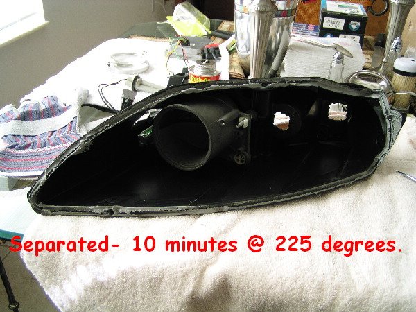

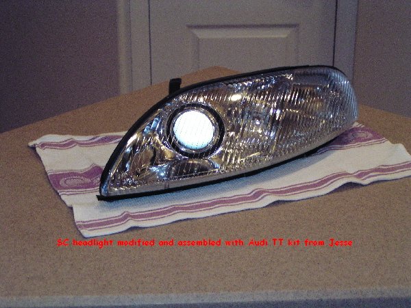

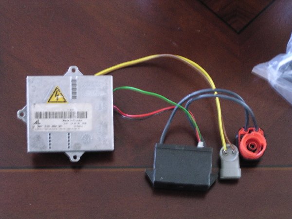

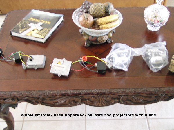

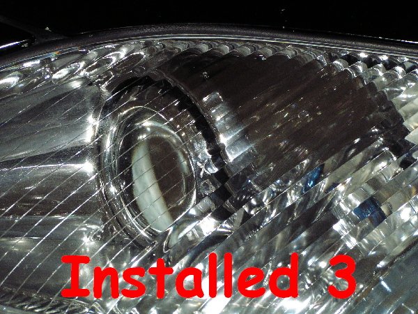

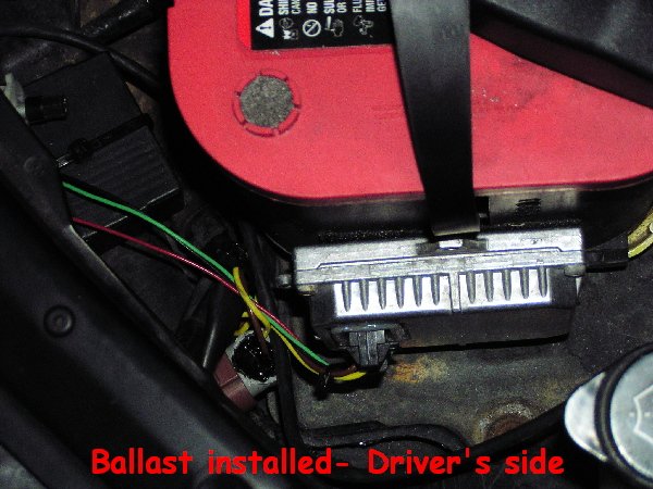

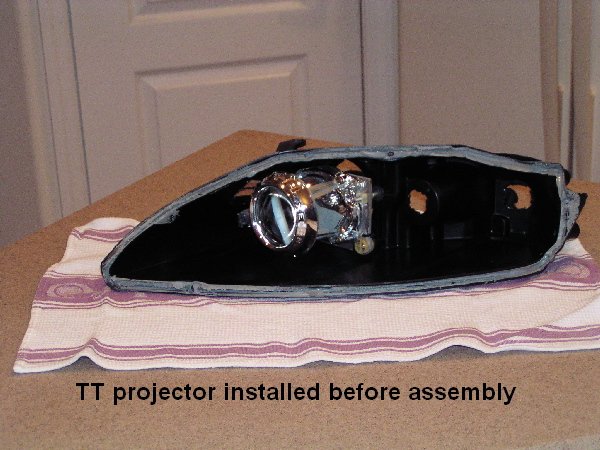

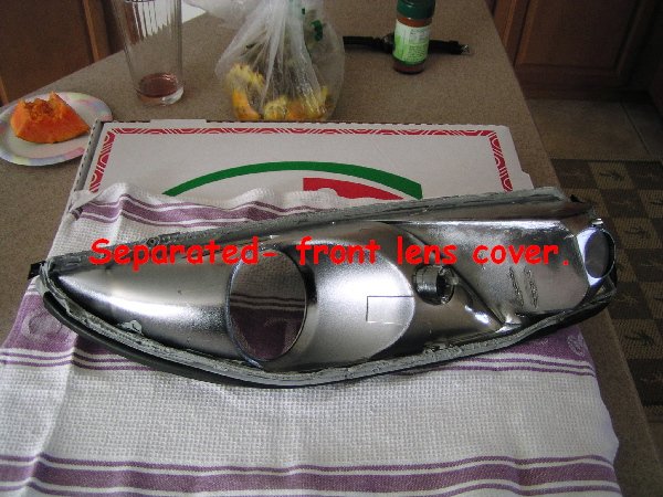

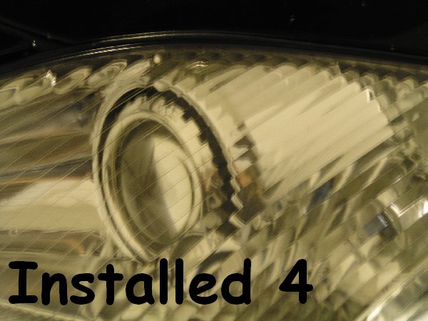

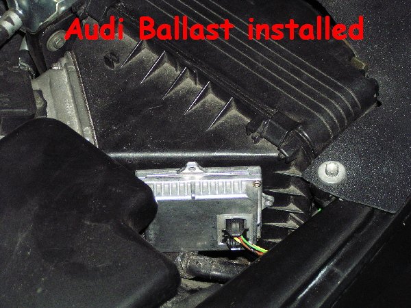

SC400TT Active Member Oct 8, 2004 #1 Gang: Here's a few pics of my HID mod I am performing right now...More to come. Ryan

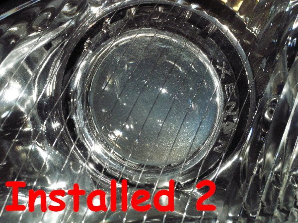

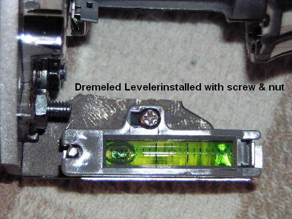

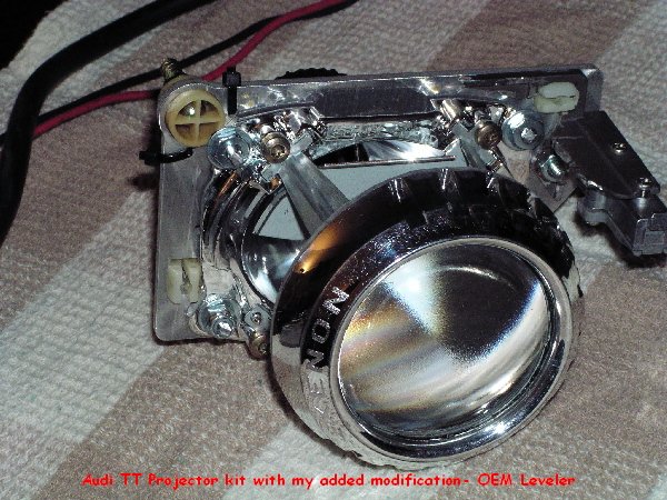

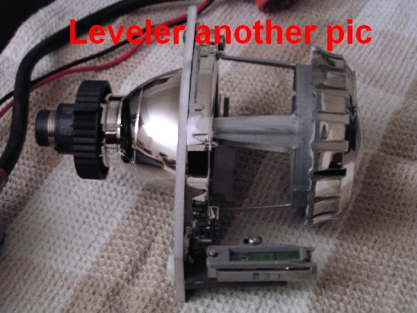

SC400TT Active Member Oct 12, 2004 #4 Here's the rest of the install guys... [img}http://www.clublexus.com/gallery/data/500/14818Headlight_1.jpg[/img]

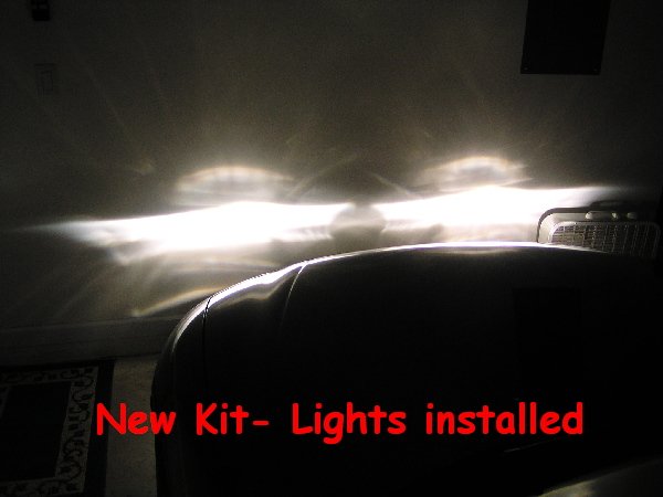

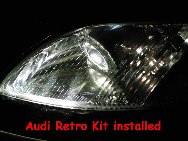

A ACleanSC4 New Member Oct 14, 2004 #7 ryan...back up a bit in front of a wall about 25 ft and take another wall shot... i haven't done that yet either, but will do soon as soon as I find a nice flat wall i can use...
