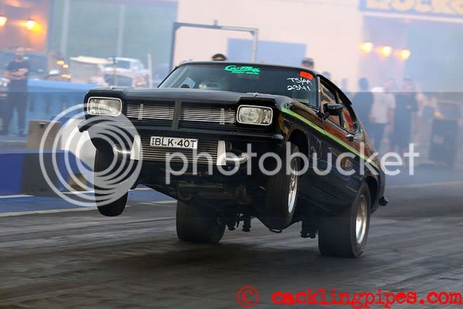

Check out member Fopar. He drives what you WANT to drive... a 1000hp 1UZFE Capri... yes... really.
http://www.lextreme.com/forums/showthread.php?t=13376&highlight=fopar

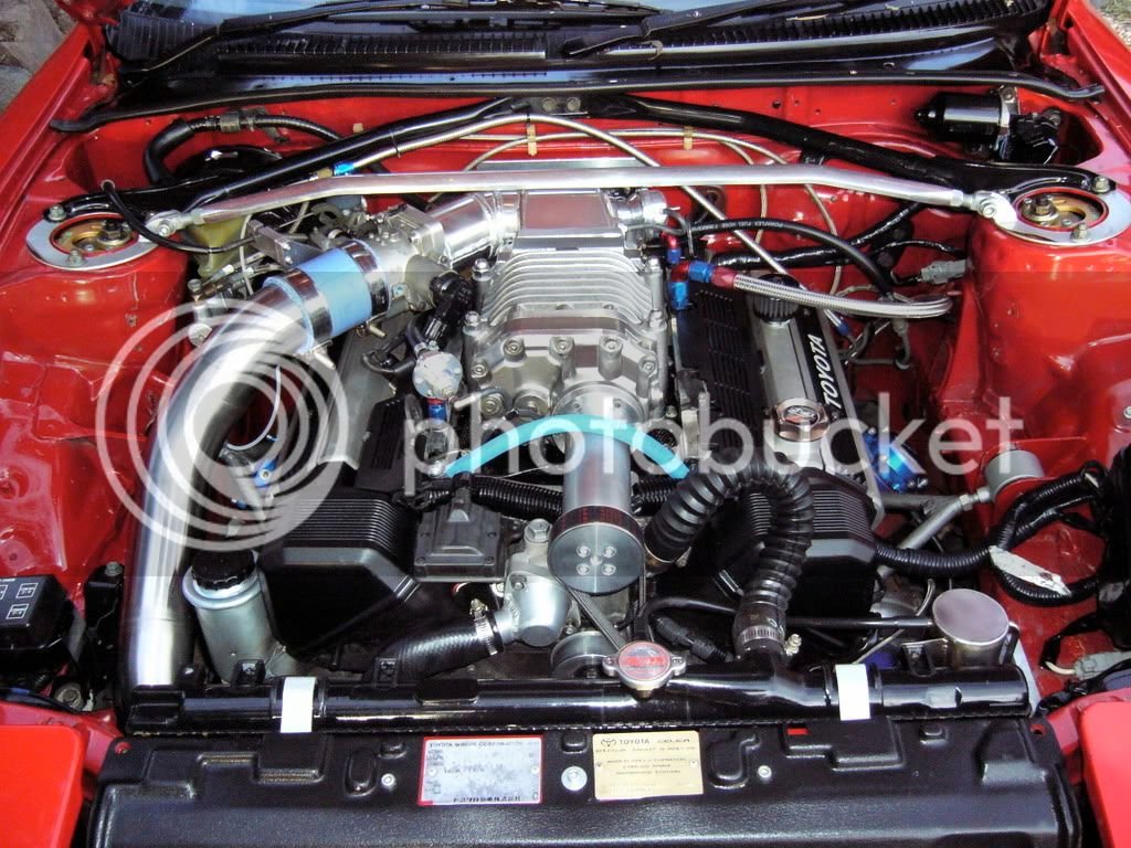

there is a guy on here makes supercharger manifolds for roughly 900 dollars delivered, im looking at getting one, maybe he will give a group buy.
Or you can do your own single turbo conversion, its relatively easy, mine is nearly done and has cost me less than 1k
400hp on a 1uz is a lot of money to invest man, a decent supercharger setup will run you roughly 2-3k for a basic bare minimum setup and turbocharging is 3.5k+

But like I said stick with it me personally am collecting parts for my sc its getting a 2uz bottom with 1uz heads, and a Paxton novi 2000 blower that right there is a deadly combo in itself.

Bullet uses a root style supercharger what I'm talking about a Centrifugal supercharger.
Justen a TT setup would be a bit more difficult and expensive unless you can fabricate your manifolds an I/C piping plus all the other misc shit will add up quick.
Even though I prefer a turbo, for ease and cost efficient power a centrifugal supercharger is the best option. Reason being that you could run 6psi w/o an intercooler, no need to figure out how to route your exhaust, and most importantly no need to tap your oil pan for return feed with a self lubricated head unit such as a procharger.
