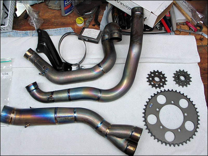

Anyone ever worked with Titanium before? It is hard to weld? I have read that you have to protect the back side of the weld with an argon shield. And you should also use something called, a trailing shield? to protect the cooling weld. What gauge, or thickness tube would you use to build a Ti. exhaust or intake system.

Now these welds may look nice, but supposedly, you don't want your Ti. turning pretty colors. It's supposed to say silver or straw color.
