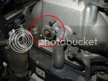

Have done a seach but cannot find the info i'm looking for. From what i have found (correct me if i'm wrong) the early 1uz's had bilet steel fuel rails and a cold start injector while the later models had cast fuel rails and no cold start injector.
Now the motor i have has bilet steel rails and no CSI. I thought the previous owner must have removed it as there looks like there is a place it should be on the intake, (See pic) BUT i can't find any free fittings on the rails where a fuel line would connect to the CSI if there was one there.:squint:
Can anyone tell me if this is normal?
Of not where should the CSI connect to the fuel lines and into the wiring loom???
