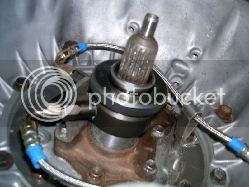

For the one not used to what the Howe TO bearing look like.
