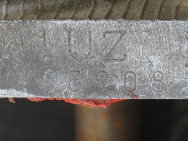

The top/front number on the block is a good indicator of the block. However, I still dont know what those numbers mean. Thomas do u have a source for those numbers? Secondly spark plug wires is false indicator of the engine/block. The wires indicate the year of the wire was made. For example I have a 1995 LS400 but the wire stated 1997. My engine wires were changed in 1997 so the brand new wires were made little bit before that time. Wire is a ok indicator but not the best. The block number is the most accurate source.
If you guys have any source, please let me know.
I took this picture just you guys so you know exactly what I am talking about.
Right thanks for thsi Info guys, very helpfull.
My block had coroded quite a bit on the bridge surface I can now only see the 1uz mark with my bare eyes,
I'll put a little dye on there tonight then pollish it up a bit and get the UV light out, that must make me able to see the block number.
If I have any luck with these numbers at our toyota dealer over here, I'll let you know.
@ david I know about the spark wires and if they where 1998dated I would have doubts, but since they're 1992's Im pretty confident that they are the originals. I don't really care about the age anyway, if it goes pop I'll rebuild if not, I've got a nice cheap engine.
Grtz Thomas

Striker,
If you look at the UZZ30 - 4.0 GT (coil suspension) and look for 46580 and 47262. My friend's SC400 engine ID is 465908 (see above picture) Ignore the last digit and you will noticed its Nov-Dec 1994 car. Matter of fact the block was from a 1995 SC400. So its pretty close. I hope this will help.
Hmmm ok david I see, might be the #8 engine in that month, uk manufacturers tend to do that system aswell (rover K series)
anyway Peewee, can you explain why it's at fault, maybe the chassis numbers are the same as the engine numbers, ot the engine number is part of the chassis number or something, renault does this aswell, you can always tell an engine swap in a renault by comparing the numbers...
I sure hope David is right, because I can just take this list to the dealer and make them print that on an official lexus headed piece of paper.
grtz Thomas
Striker,
I am not sure. Peewee brought up a good point. I didnt know the link until a visit email me the same question as this thread. So I told him that I dont know the block number and its history because I dont have the referrence. Anyway, few days later he email me the link so I share it with you guys. As for my friends 1995 SC400 block seem to work. However, I still think its very limited. There are few other version of the engine in different models are not listed. So, I am still in search of a complete list.
