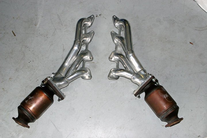

I have ordered s&s headers for my 2004 LS430 and need some input about what to do with the EGR. If lextreme's kit will work on this, I'll get it, that would be the simplest.
Thanks
Keith

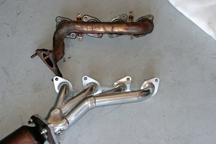

yes dave's plate should work just fine. I did the same thing. just made my own plate. Heres a not so great picture, i never took any pics of the side of my motor.
