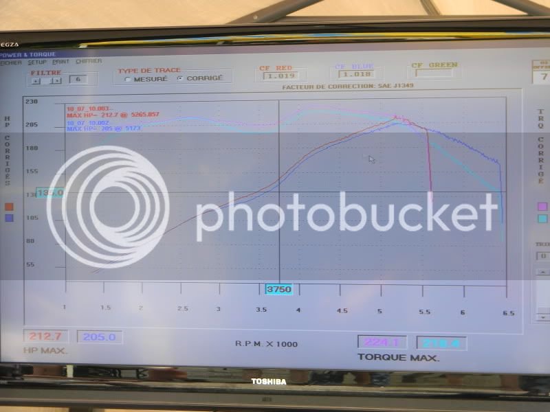

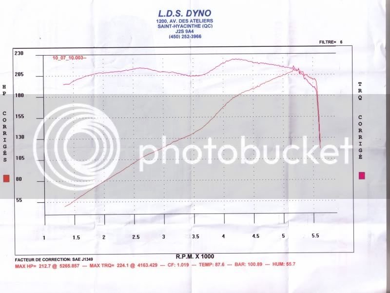

Engine: is from a 1991 LS400. 200 000 miles unopened stock engine
Mods are: modified stock manifold up to stock catalytic converters and Y pipe to a single 2 3/8" Pipe and mufflers, open air filter, lightweight flywheel mated to a w58 manual tranmission and the fan clutch and A/C where removed.
I really like the flat torque curve, but kinda wonders why there is a drop at 3.5k rpm. My guess is that the pressure waves caused by the valve in the intake and the exhaust is out of phase in both the intake runners and the exhaust manifolds while one of them is in phase at 2.5k rpm and again at 4200rpm and the other one is only in phase at 4.2k rpm.
I kinda like the fact that lexus advertised the maximum power at 5600rpm when it's actually dropping quite fast in that region.
I don't know why the best run was when the guy left the trottle at around 5600rpm.
