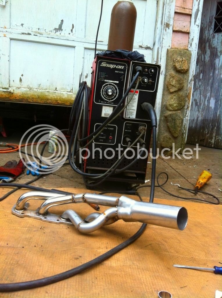

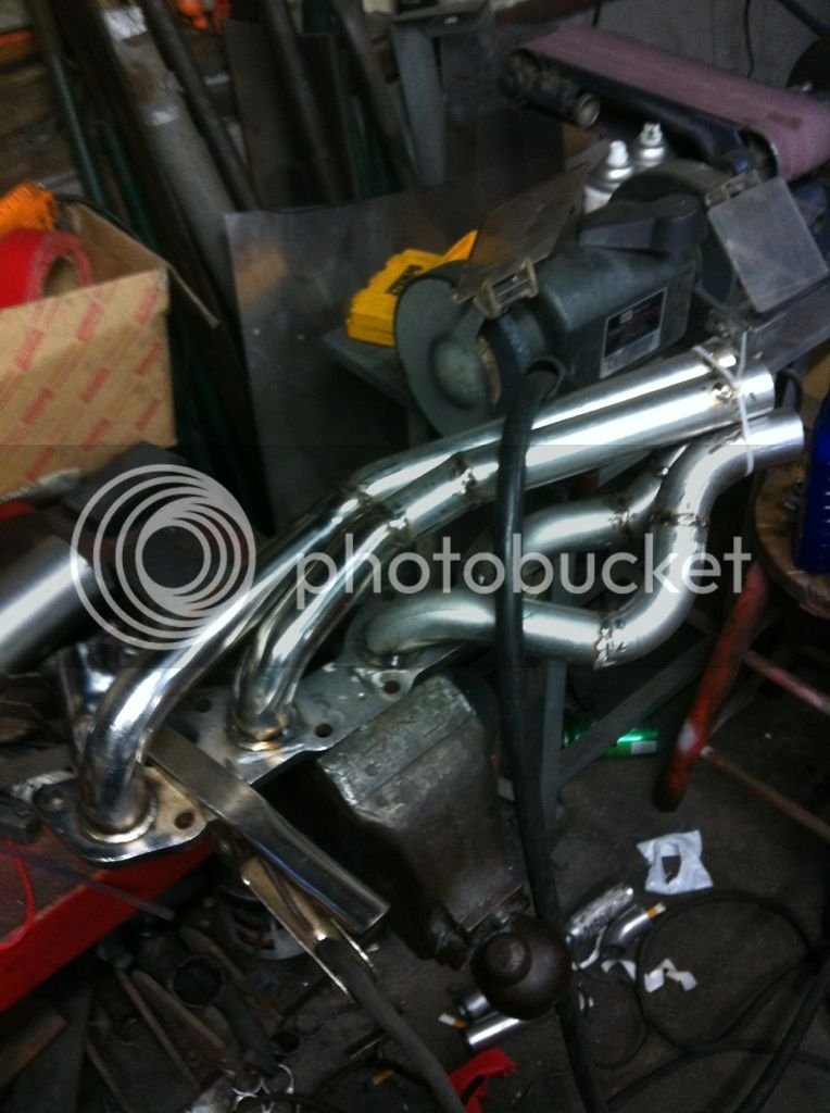

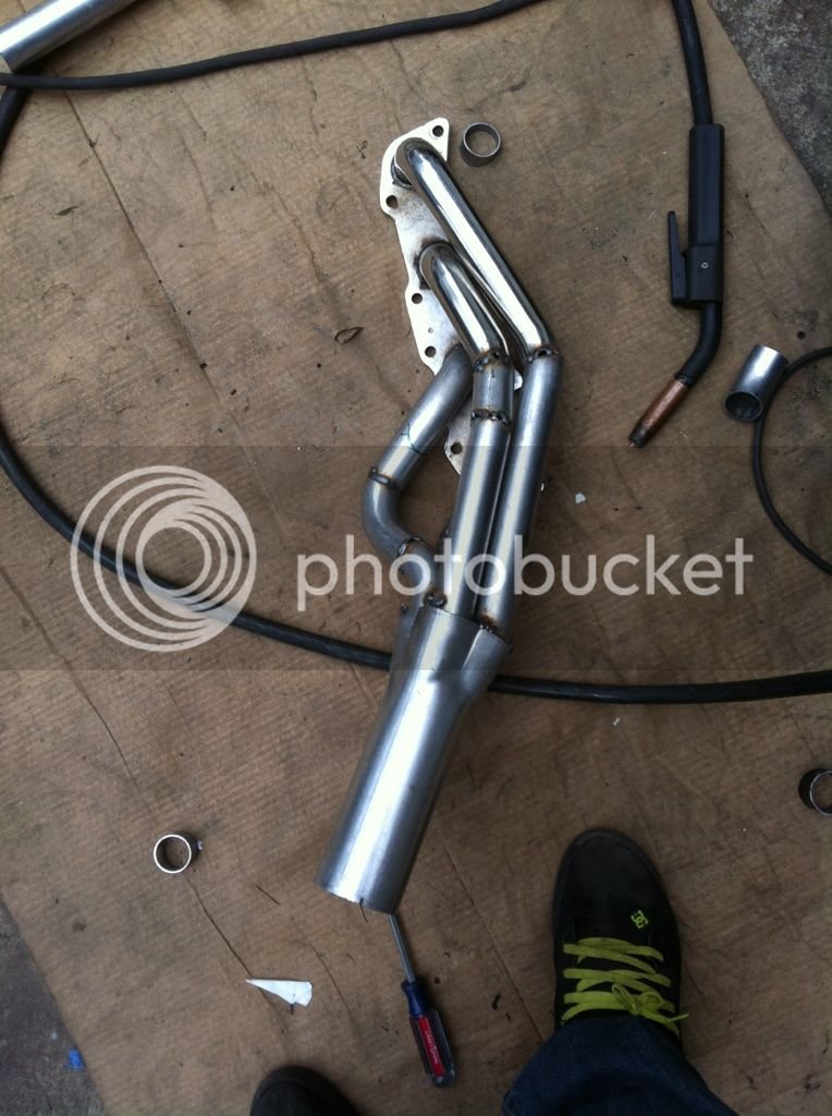

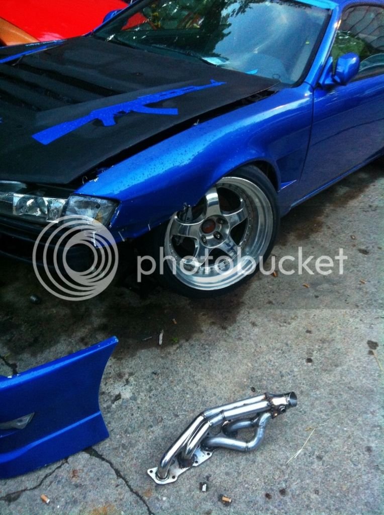

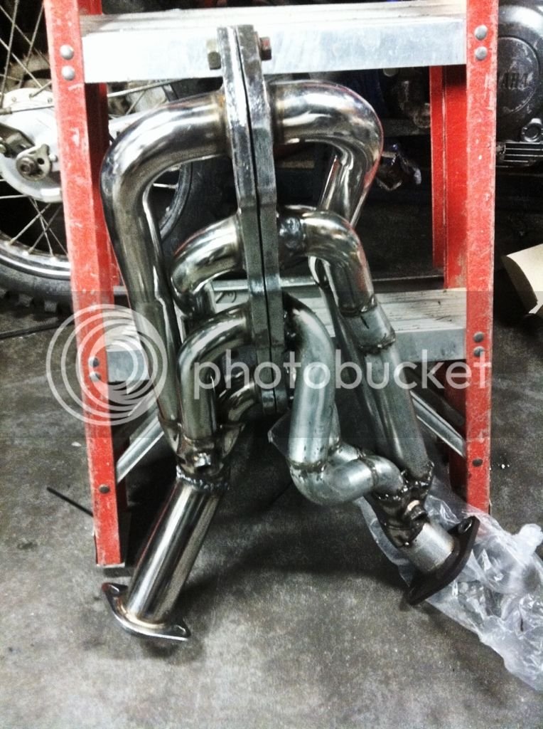

Thanks RPS. I actually already had this picture but it wasn't as large and detailed. Do you have ay other pictures from other angles? and am i correct in saying that you bent the third pipe (second from bottom) around the steering? and also what about the fourth pipe?
I pretty much reworked the whole driver side header besides the first pipe. I also ran 3 and 4 around the steering shaft like you mentioned. Here are some more pics. Hope these help
Thanks that does help a lot to clear things up. I unfortunately cannot weld so I am having a third party do it for me and its hard to describe to him without pictures. That collecter is pretty interesting too. Is it a 3" out?
I just used the big collector to line up the runners when I was making it. I ended up using the collector from the original tundra manifold that i cut up and that was a 2.5 outlet
