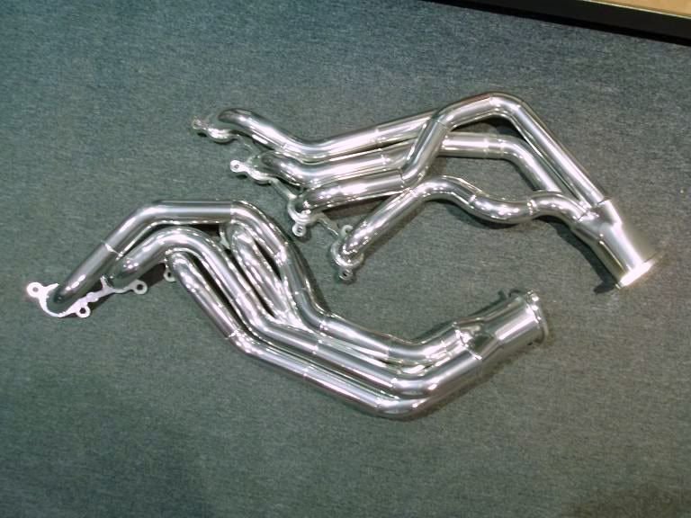

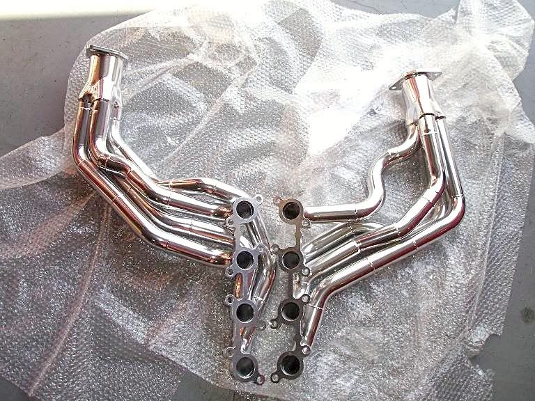

im not sure how much it would help but cutting the flange down to only having a flange per runner may(and thats a big may because im not sure) help but not having the big surface area contracting at once and that should help the warping issue

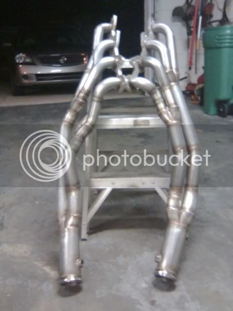

Mine sound great with my exhaust.. I built everything, Headers (extractors) and exhaust. They are Tri-Y's though and that might be making a big differance. The exhaust is all 2.5" with 3 mufflers, the first being a dual inlet/outlet with a built in X-pipe. Behind it are two single inlet/outlet mufflers and then straight out the back from there....
Here's a pic of the hearders after I finished them
Heres a link to my header build thread on here.
http://lextreme.com/forums/showthread.php?t=10583
And here is the only video or the car running that I have thus far.
http://www.youtube.com/watch?v=j300OZt5ah8
