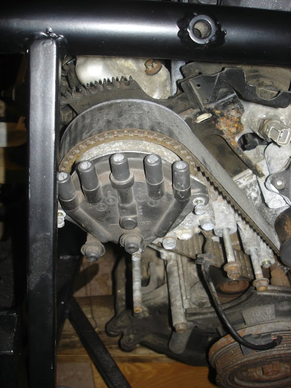

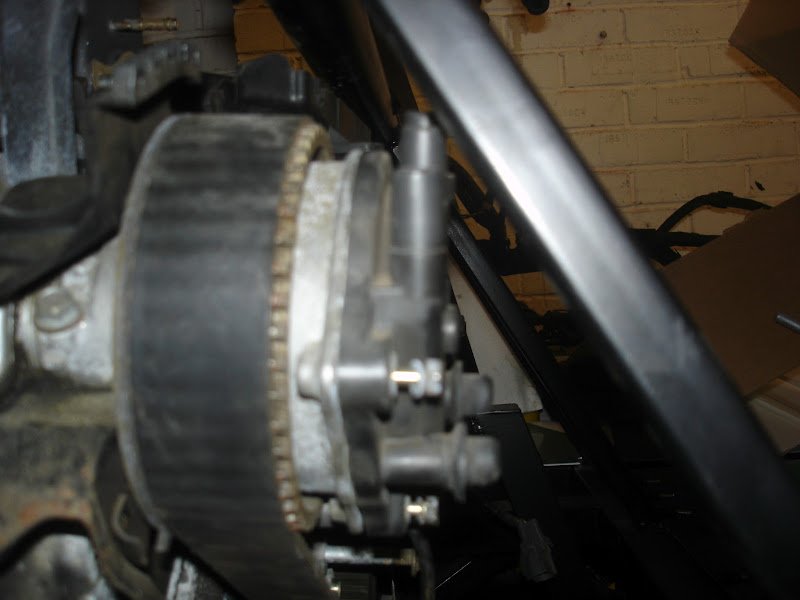

Has anyone got rid of the existing distributors and gone COP/CNP or just plain wasted spark on the 1UZ-FE combined with the stock (ideally the early 89-94) ECU?
It would make my life a lot easier if I can lose the distributors (due to space constraints) but I'd rather keep the existing ECU and injection setup (for now) as when my car is complete it'll have to pass emissions tests, easier to do that as 'stock' then play afterwards.
Can you get an EDIS or some kind of aftermarket spark only ECU to play nicely?
