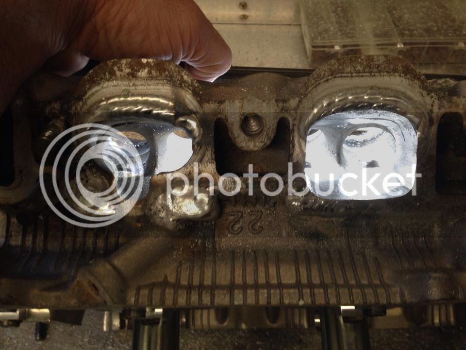

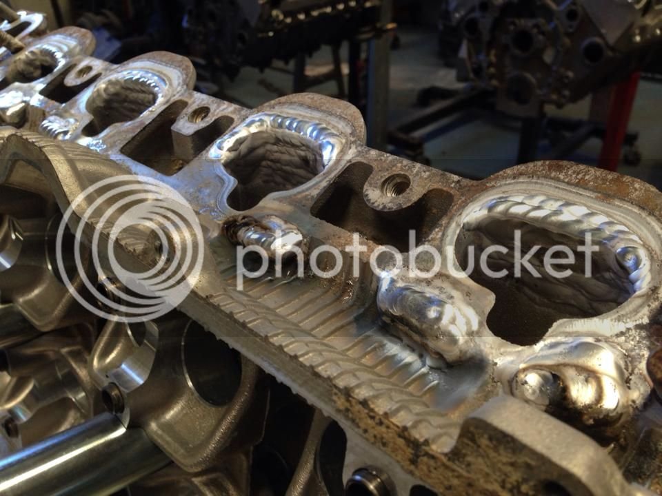

while we are finishing off a freshen up for the old engine, work for the new head has begun, in the way of a nice new port job for the heads, Jake @ Bain Racing has started on the new cylinder heads for the little Capri, these will be an integral part of getting us into the 7's with only a little baby 4L street car, Jake has been a huge part of making the whole combo quick n reliable, he did all the head porting, intercooler, fabwork, radiator, cam design etc on the car, he did a set a few years back which flowed [email protected]'' (1mm OS valve) which is about 50cfm up from what we currently have with our mild factory valve port, as you can see it will be a high port, so he has to weld it up and will shape from there.
this is just rough at the moment is a looooong way to go
![1390676_10202192968096582_1962679967_n_zpsdce1a391.jpg 1390676_10202192968096582_1962679967_n_zpsdce1a391.jpg](https://www.lextreme.com/forums/data/attachments/22/22706-a3a55ea327e8544b4bd70eaf4ae36d68.jpg?hash=o6VeoyfoVE)
![1382208_10202198474594241_1150514636_n_zps9843f664.jpg 1382208_10202198474594241_1150514636_n_zps9843f664.jpg](https://www.lextreme.com/forums/data/attachments/22/22707-042991195eb4dbe224337e3b7097be8e.jpg?hash=BCmRGV602-)
