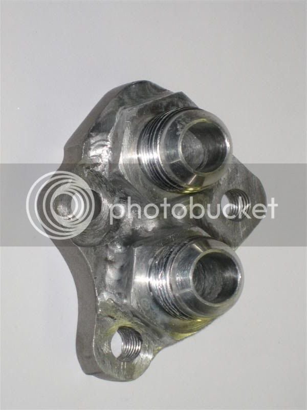

Thomas, why not go full remote on the oil filter? Here's my oil filter adapter plate modified to take -10AN's. That way you can easily incorporate an oil cooler, which you'll probably want anyway since you're twin supercharging that beast, and your oil system is going to get a real workout.
Oil cooler will also be a laminova Item which can go in the original crown assembly oil line,
I do like my cheap stock parts. and I don't want to see my oil filter when opening the rear engine cover on the car, it'll be a clean install without hoses and looms showing so the less hoses the better + that most remote installs do not really aid after start oil presure build up, stock is best with the addition of a cooler.
