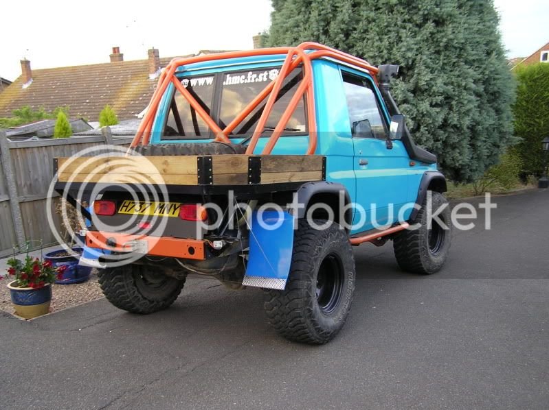

A couple of pic's and vid.

![PA050002.jpg PA050002.jpg](https://www.lextreme.com/forums/data/attachments/20/20187-12c7bc6a441cadadb64ac485d073f025.jpg?hash=Ese8akQcra)
