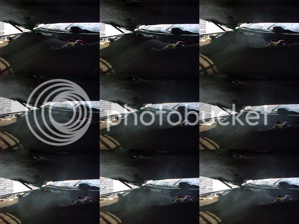

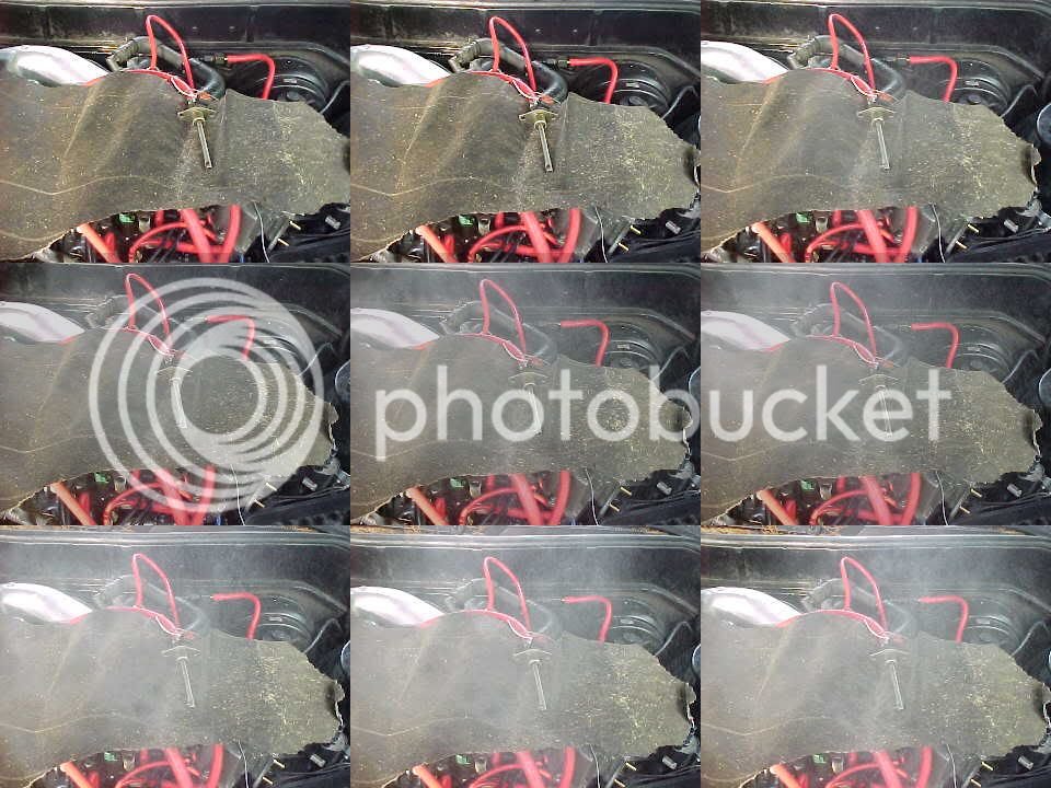

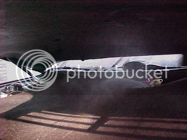

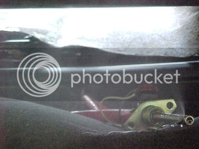

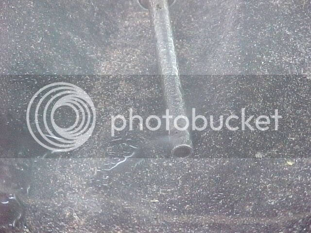

Cold-start injectors are a solenoid with an atomizer on the end of it.
Give them specified votlage (12vdc) and the solenoid opens, letting ufel run through it.
There is no adjustment, they're either on, or off. No pulsing.
Most are in the 100cc, 125cc, 150cc range.
Good atomization tho.
