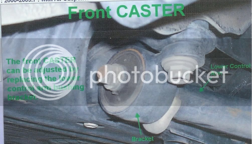

Just had my car's geometery checked and the caster is way out, its even both sides but over 1 degree outside the allowable range, Lexus sell replacement lower control arm bushings in different sizes to adjust the caster but this will only bring it within 1/2 degree of tolerance.
Lexus say it doesn't matter as they are both even but the suspension guy says this is a long way out and tyre wear will be excessive (which it is, shot a pair of front tyres in 6000 miles on the inside edge)
Has anyone seen/heard of an adjustable mount for the 2001 LS430 that would allow more adjustment..
Any help/ideas, greatly appreciated
Thanks
Pete
