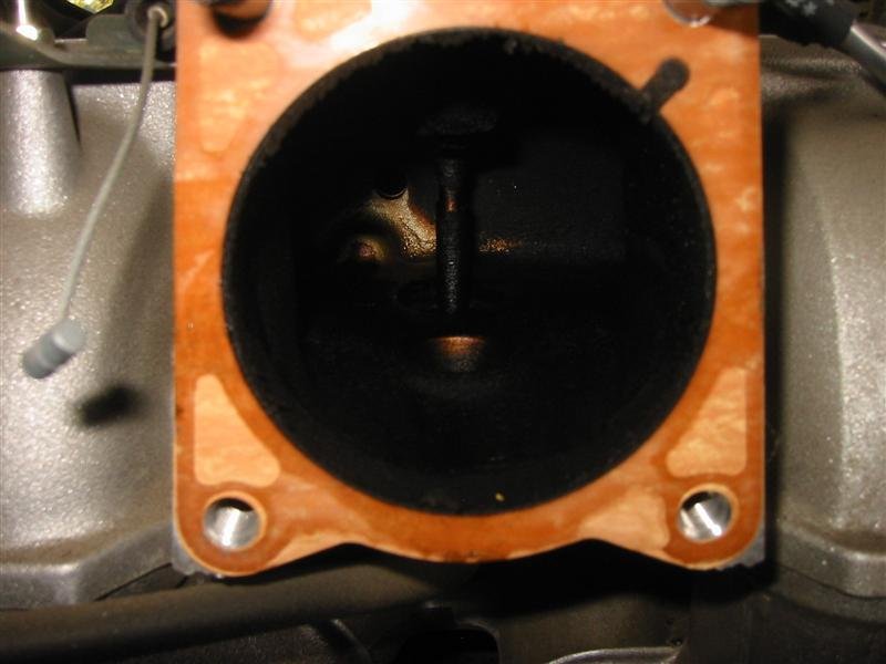

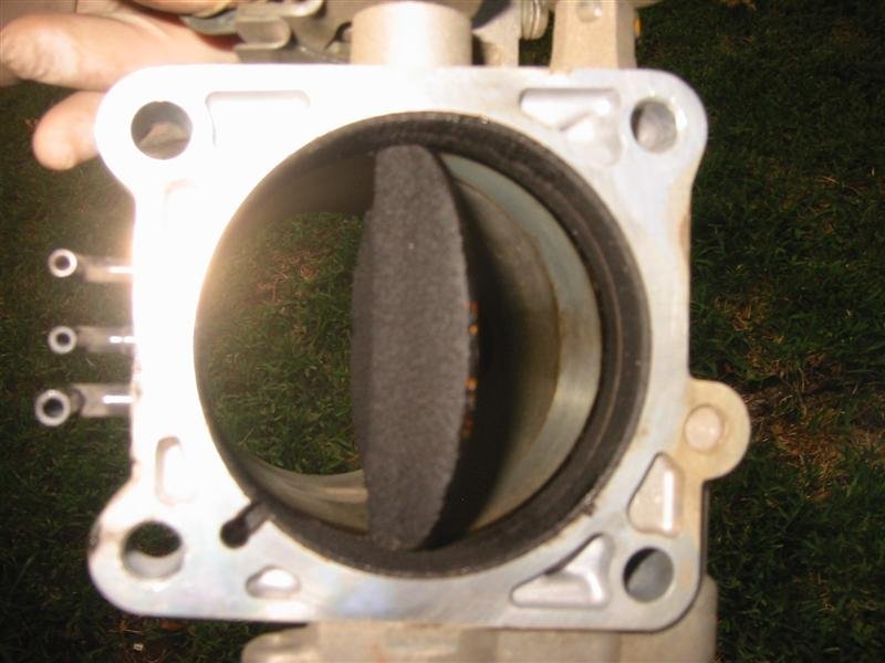

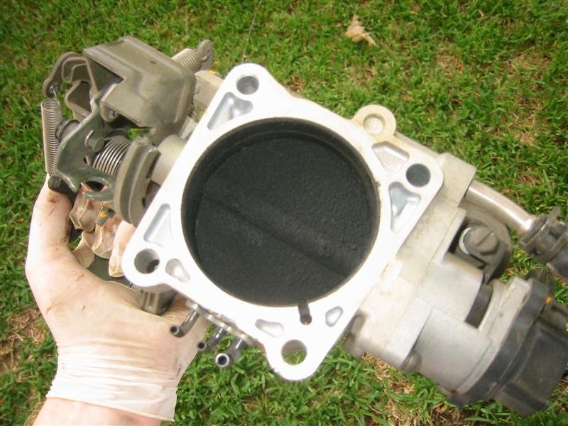

Carbon Buildup
Start using seafoam.
Seafoam / water injection own carbon, very, very well.
(cough and ditch any EGR system you have if you don't ahve emessions LoL! Doesn't Lextreme sell an EGR plate & such for the UZ's?)

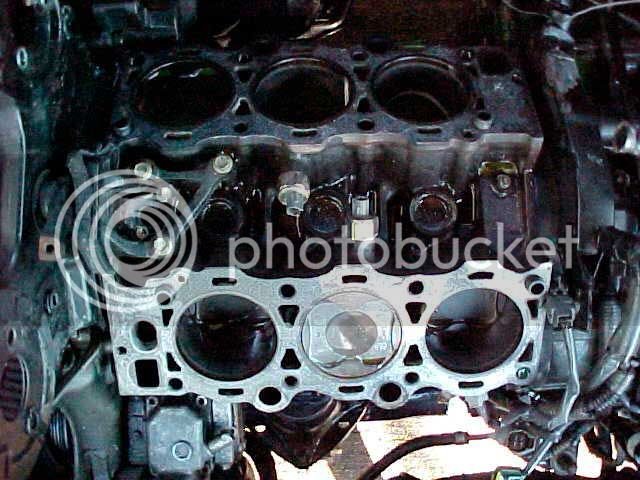

If the intake looks like that, you're loosing some velocity through the entire intake. Not to mention your pistons are going to look atleast as bad as mine originally did on this v6.
Nasty.
egr stays.. we have emissions in dallas.. i wanted something that passes with no effort so i bought this thing from my grandparents. the buick is the fun car ;)
been using seafoam for years just not on this car.. yet
