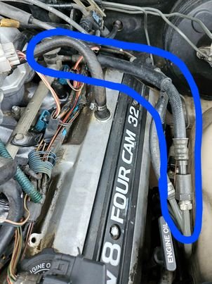

SO BASICALLY, while working on the starter, I flipped the fuel injector rail upside down instead of disconnecting it, and I guess the fuel inlet hose procured a small leak since it was partially dry-rotted. I figured this is a easy part to fix, since its just a simple fuel rail hose. But after 3 hours of research, I cannot find a single place that has a part number, much less one for sale. I am currently at a stand still, and while the leak isn't bad, its something I need to fix asap. Does anyone have the part number, or a link where I can buy this stupid fuel hose, or even have a way for me to jerry rig a new one on?

If you can't find a replacement take the hose to an hydraulic hose shop and they will make you a new one using your old ends.
I've had it done for fuel lines and air-conditioning lines.
Thank you both for the response. Zuffen, I did not know that could be an option for hoses, so thanks for the tip!

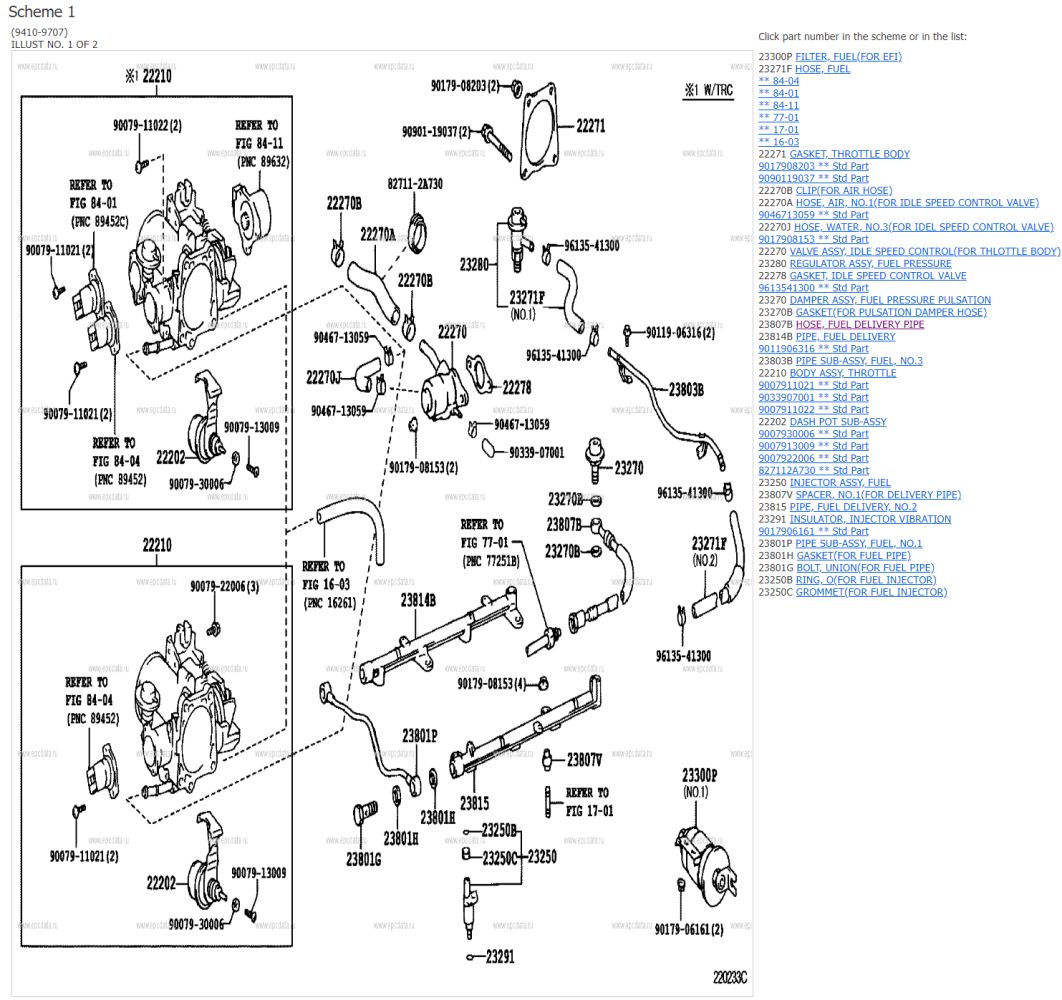

Thank you so much for that video gloverman, it actually helped me find the diagram that was missing, and led my towards the right direction. After diving into the website, I found that the part number was 90923-01407, and it is out of stock in a few places. However, it doesn't seem impossible to find anymore. I appreciate the much needed help!
To help anyone else out trying to find fuel system hoses, here is the diagram the website (Japanese cars online catalogs) gave me: 1700366882073.png
