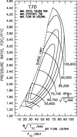

What turbo for grassroots single turbo? My goal is 400hp on the street.
I would like to keep the budget for the turbo at aroud $500-600.
Here is a chart of the 1UZFE pressure ratio vs. air flow
http://www.lextreme.com/GT.html
Engine Liter Cubic Inch Air flow Static 6 psi 8 psi 10 psi 12 psi 14 psi 16 psi 18 psi 20 psi
1UZFE (AirFlow) 4 244 367.26 cfm 35.74 39.08 42.633 46.044 49.4905 52.937 56.3835 59.83
Pressure Ratio 1.41 1.54 1.68 1.816 1.95 2.086 2.2216 2.3572
Here's a couple turbos I'm considering:
Master Power t70. These are really popular with the turbo mustang guys.
http://bgturbokits.com/store/index.php?main_page=product_info&cPath=2&products_id=79&zenid=bc2f8a9770478c79e8fe48702fcbbabf
Holset H2E, maybe H1E or HX40. I'm not a big fan of the odd ball sizes v-band and the integrated WG. They are also in demand for the turbo diesel guys, so are pretty expensive for a used turbp
And the ebay ssac stone "t70" Which is supposed to be more like a t61. A bit smaller, faster spooling, on the edge of the efficiency island. But **** is cheap... $375 including 50mm WG and bov. I have seen a couple people run these on HMT, without problems. It's pretty tempting.
http://cgi.ebay.com/ebaymotors/Turbo-Kit-T70-Turbo-HKS-STYLE-WASTEGATE-BOV-NEW_W0QQcmdZViewItemQQcategoryZ33742QQitemZ8044642906QQrdZ1
http://cgi.ebay.com/ebaymotors/NEVER-USED-Super-T70-Turbo-RX7-S13-S14-Supra_W0QQcmdZViewItemQQcategoryZ33742QQitemZ8044682561
I am open to any suggestions.
