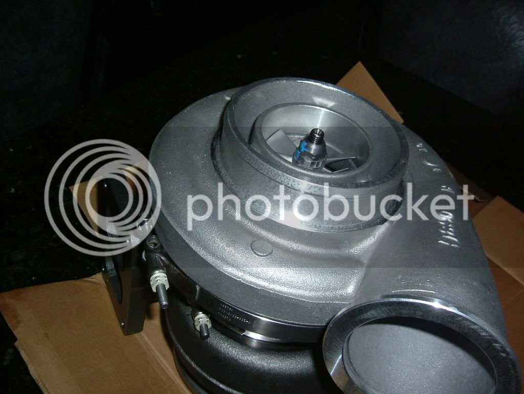

I'm fitting up an S475 on mine..[800 -1200h turbo]
But for street the smaller S300 series would be better..
They are not ball bearing [yet] and require plenty of oil feed ..
But they perform well, many drag records have run these turbo's.
Their extended tip wheel seems to work well..
Yes the S300 series would be better for street turbo..
This one has 1.32 AR / 84 btrim T6 flange.. Its for all out drag racing, power cruise events.. Go or blow...
There is a modified rear housing with Garrett T4 housing where .94 / 1.01 etc housings make them very streetable...
