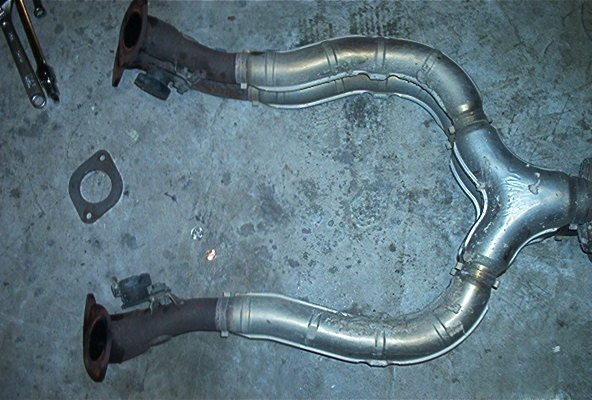

So, I am finally able to focus on this situation. I will build a performance Y pipe for my LS which has a nearly identical Y pipe to the GS. The LS is heavier so it is even more important to keep low end power. If I successfully make a better than stock Y then we will have a repeatable design to copy.
My experimental Y pipe will feature a high velocity one way merge like the stock part does. It will be smaller than 2.25" but larger than stock. The LS Y pipe is VERY similar to the GS4xx. The LS and GS engines are identical.
Look closely. This picture shows the LS400 Y pipe on TOP of a GS400 Y pipe. The GS430 Y pipe is also identical except it has a center catalyst instead of a center resonator. The GS has a larger inside diameter center resonator than the LS400.
