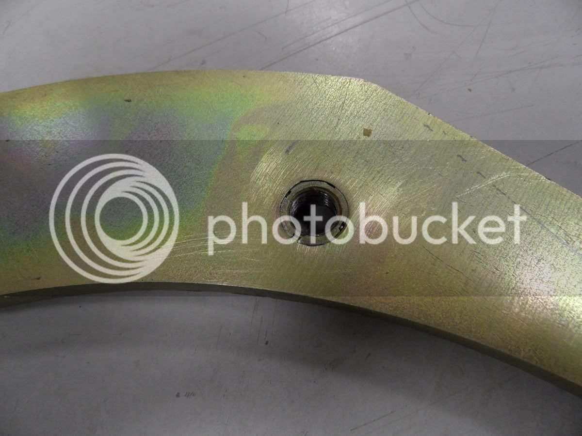

So spoke to eric again and he said nope the plates are 100% and that 40 cars run these and had no issues. Now i have mapped 2 cars with these adaptor plates so said yes i know they are normally fine but mine are not as the dowel locations have been messed up in the machining and helicoiled again to move them... Eric suggest this is how they are all done!!!! WTF.... Some real quality work there...

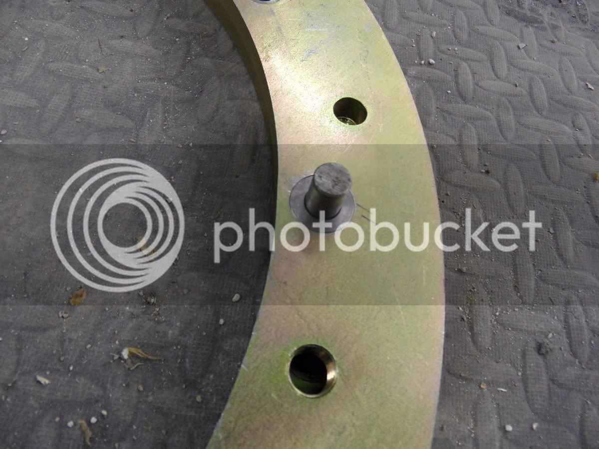

He are my plates as i recieved them and a vid of the whinning which only was there when the gearbox was turning. Dumping the clutch got rid of the noise…
![Picture4.jpg Picture4.jpg](https://www.lextreme.com/forums/data/attachments/19/19755-203cf40206484ca9e8701cfd0a1848ba.jpg?hash=IDz0AgZITK)
![Picture3.jpg Picture3.jpg](https://www.lextreme.com/forums/data/attachments/19/19756-2118b1b979cc3f4907b8ab8159a19cef.jpg?hash=IRixuXnMP0)

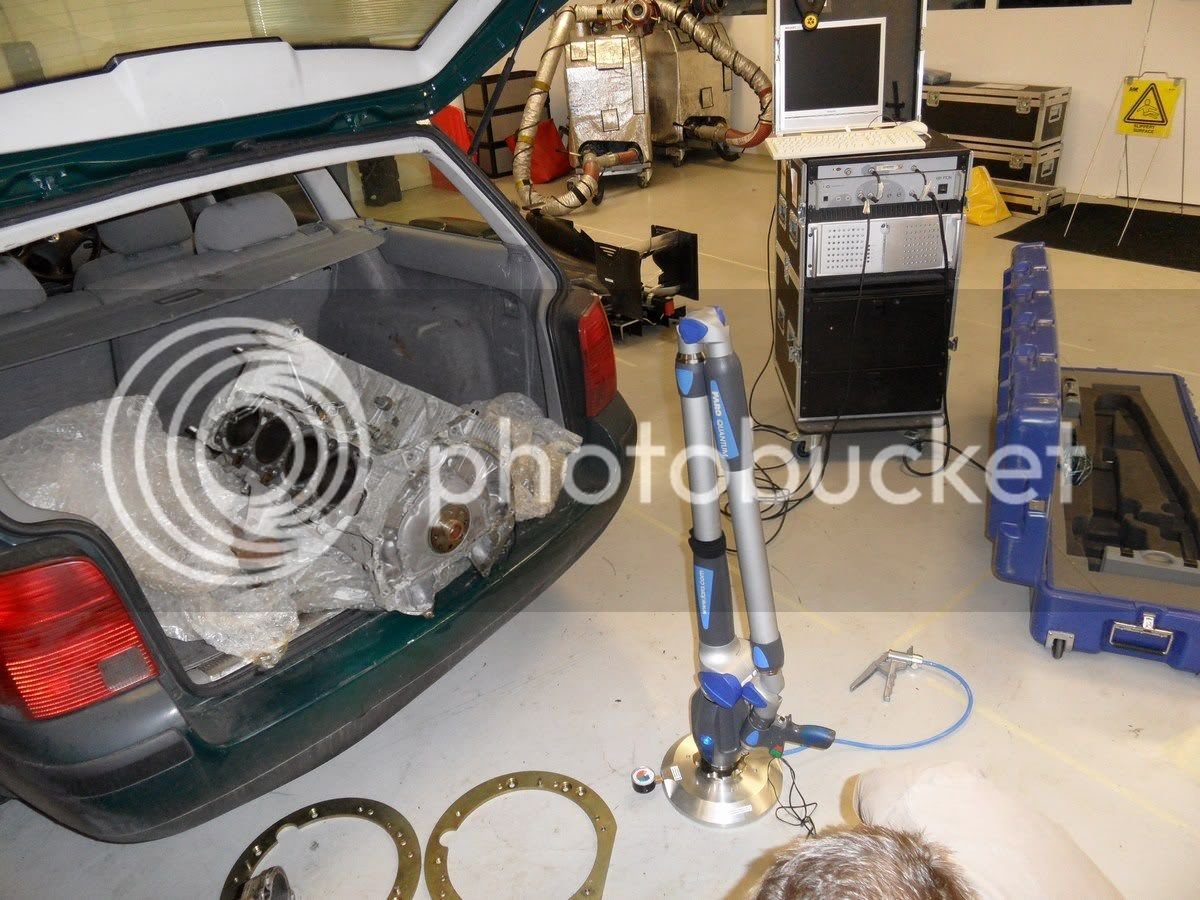

Soooo decided to get the plates, engine face and gearbox face i
nvestigated using a Faro arm which Eric stated they were originally measured up on.
Well we found the plates to be 0.7mm out on the centre!!

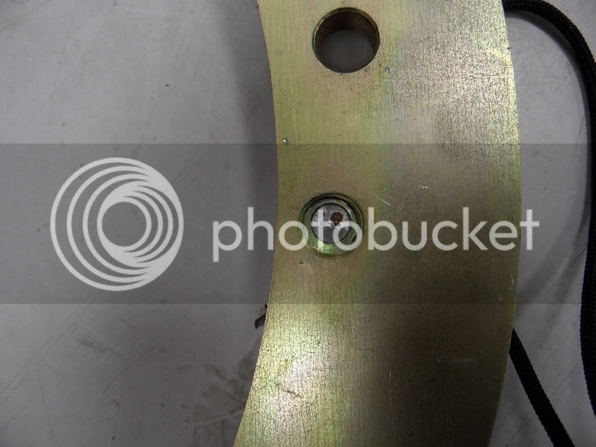

![Picture7.jpg Picture7.jpg](https://www.lextreme.com/forums/data/attachments/19/19757-14a8f7784fccd3c2428fd55e236ec477.jpg?hash=FKj3eE_M08)
![PLATESALIGNED.jpg PLATESALIGNED.jpg](https://www.lextreme.com/forums/data/attachments/19/19758-5e22e1844a9b00ca1f797c583d7d99f1.jpg?hash=XiLhhEqbAM)
We even found that the plates are that well designed that the starter motor hits the gearbox!!
![Picture1.jpg Picture1.jpg](https://www.lextreme.com/forums/data/attachments/19/19759-ff899bc4a3d7c41f6a1e5821dbfc1c11.jpg?hash=_4mbxKPXxB)
Had the Dowel location moved properly by a local engineering and no more whining!!!
