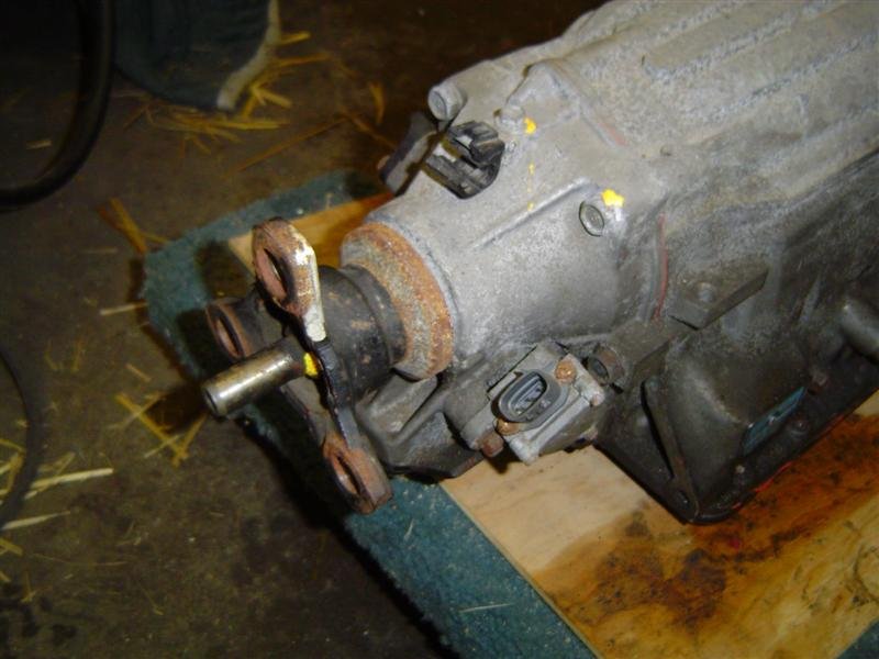

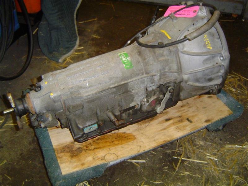

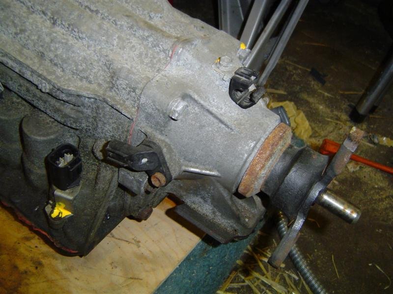

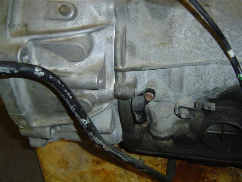

Here's some shots of a 92 LS400 A341E - not sue if this helps or not:

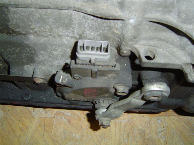

Connector:
Gotta check and see if this pic is from the A341E or the A340F. EDIT: That is the A341E pictured below - it has two speed sensors one up front and one at the rear.
Cheers for the photos everyone. That last pic by Peewee looks like just what I need. The extension housing looks near identical to my Cressida unit. Just checked my EPC, same unit, awesome. All I'll need to do is to mount my SP2 sensor adapter plate(like Peewee's unit) and over swap the modified rotor. Even could make a new one.
It also has the same front speed sensor and the valve body connnector. I'm going to the city tommorrow to pickup a Crown unit like this up.
