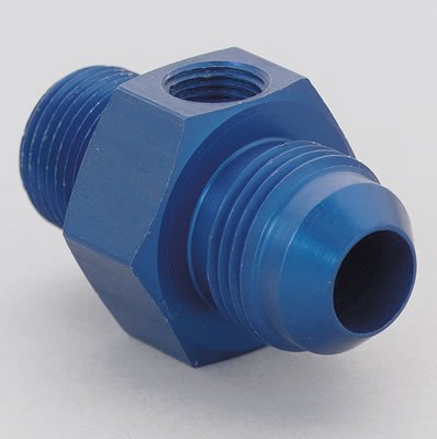

You got PM about the wheel. I got some great news on it. The plate will be 3/8" thick aluminum with 3/8" npt pre-threaded. From the 3/8" npt (female) you can put in anything you want with it. Such as 3/8" npt male with 8 AN male or any combination with 3/8" npt male. I will have pictures in a week or so. By doing this mod you will save alot of room for turbo manifold. I will not charge any extra then my cost plus shipping. As for the oil pressure sensor. You can get a 3/8" npt male with 8 AN male with a 1/8" npt side port. Earl's part number: from Summit Racing: AER-FBM2279
