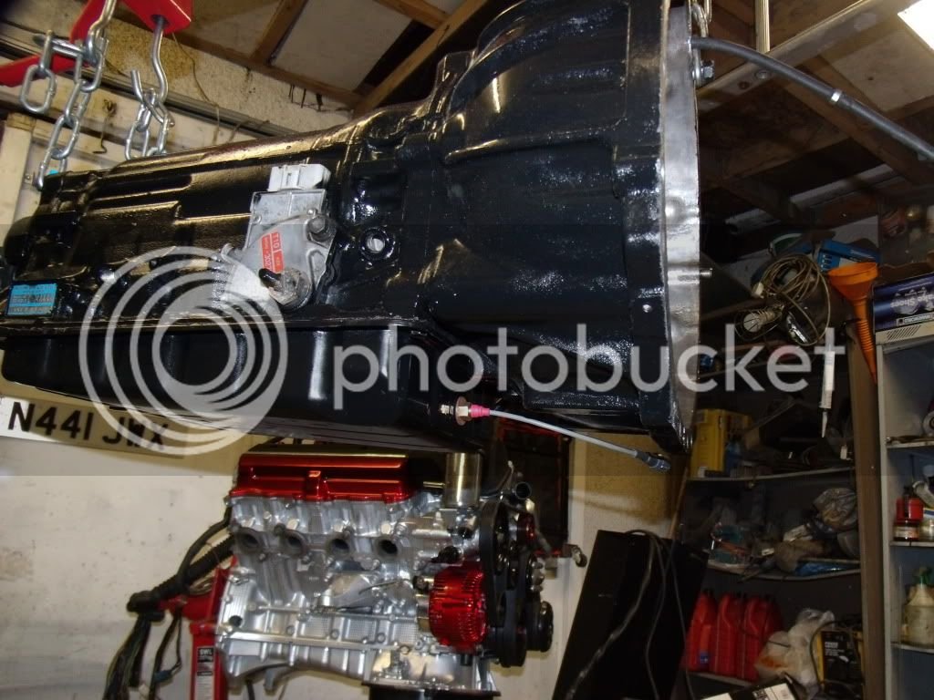

Is there a 'test port' to put a trans/ fluid temp gauge sensor into ?
... I want to put a trans/fluid temp gauge in... has anybody done this ? Are there any surgestions as to what one to use ?

Trans shouldn't be bad, get a t-fitting and put in the cooler lines. I would consider one in the outlet of the trans one and at the inlet. Then you can see cooler efficiency.

There is a temp sensor in the pan but tapping into it can cause the ECU to get a different reading due to the multiple pullups involved when the signal goes two ways.
