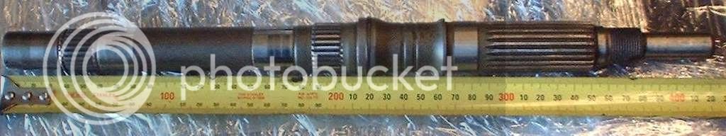

I plan to buy a Toyota 1JZ GTE engine or 1uz which comes with a A340E tranny and swap the output shaft with this AW4 output shaft. Then I will mate this to a NP231 transfer case in a Jeep Cherokee XJ
Depending on which one you get The 1uz comes with a A341E transmission which has a shaft which looks much the same as that shaft but is a bit longer with more spline and a thread on the end. An AW4 is an A340E
