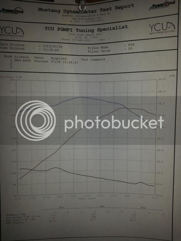

91 Lexus LS400 in a 1989 240sx.
RxGlassjaw
1UZFE
Chopped up Tundra headers
2.5 to 3 inch exhuast
KA trans
Solid driveshaft
11lb flywheel
3.5 intake elbow
210 whp
226 wtq
on a mustang dyno
Does the tundra headers offer an advantage over the stock LS hearders?
What i've heard the Tunrda headers are a little too large for 1uz because of the displacement difference in the motors, But for me it was the cheapest easiest way around the steering shaft.
