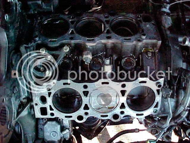

what bore is the 3VZ? its 94mm isnt it? what is the weak point on the 1MZ pistons?
I would love to think about using a 1UZ-FE piston, but I havent seen a decent picture of the std factory piston yet. The asftermarket piston pics tell me it will be close, but the money shot is the std piston closeup. It is intended for NA use, no snail to be fitted, about 11.6:1 final required with my cylinder head.
Mike
Same as all more modern production Toyota engines. The compression is too high for the ringlands to ahve been moved up the side of the piston and the hypotenuse between the top of the piston indent and the ring s too small.
Leading them to be far more prone than older pistons to cracking off.
All 2.5L-3.0L Toyota v6's are 87.5mm bore's.
3mz-fe's are 92mm
5vz-fe's are 93.5mm
Some of the newer GR block v6's are 94mm But they share the lighter, weaker designs to the pistons, VASTLY incraesed compression ratio (and you don't have the same level of vvt-i mixture control, and oil squirters to help them survive)

3vzfe is 87.5m . I know the the 3vzfe would handle a decent amount of boost compared to the 1mzfe so if any has a 92-93 es300/camry we could compare pistons to 1uzfe to see if we could drop compression with them. I was running a boosted 3vzfe in my 2nd gen mr2 before I sold it. the 3vzfe pistons are almost identical to 1uz but drop the compression by .4..Edit: 3vzfe gives a VERY modest drop in compression.Not worth it. The 5sfe however is a good low compression upgrade but you need to get .5mm over since stocks are 87mm
