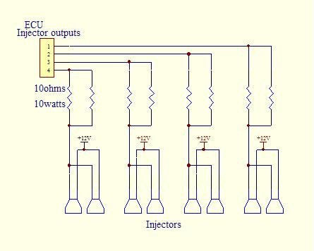

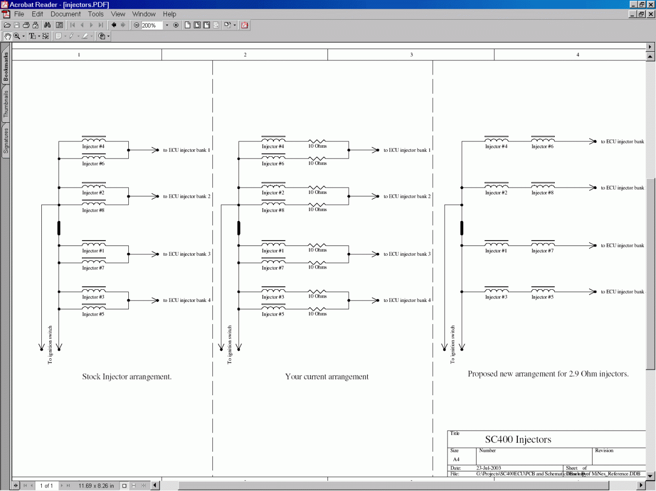

Has anyone tried the injector configuration in the last diag, where the two injectors are connected in serries. Its how I was going to connect mine up when I get the 7mgte injectors fitted, the wolf ecu will not drive down arround 1 ohm ( as the resistance would be half that of a single injector if connected in the stock arrangement)..:hypnotized: :hypnotized:
