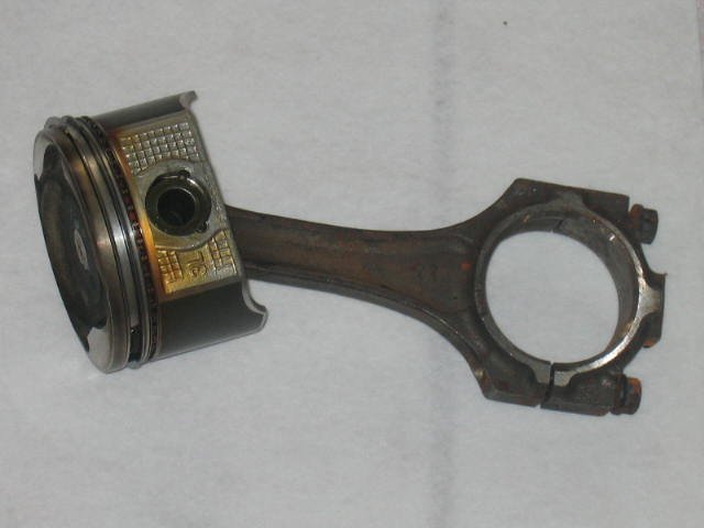

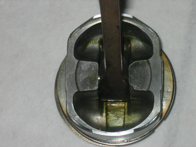

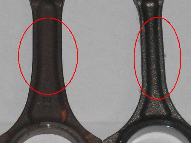

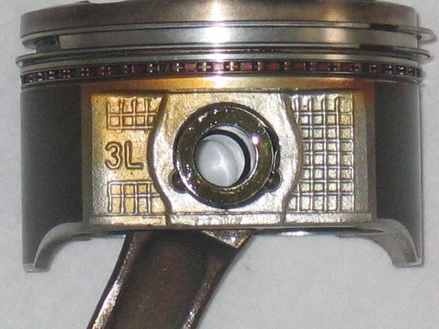

Here is what i did. The 3UZFE and 1UZFE rod length are the same. However, the 3uzfe rods is extremely weak. Therefore i replaced with 1uz rod. Check out the pictures below.
Here is a picture of the two rods. 1UZ on the left and 3UZ on the right
Has anyone actually done tests to prove the 3UZ rods are weaker?
Just because they are smaller/thinner does not make them weaker.
Are they the same material?
Also, a lighter rod makes for less rotating mass, which inturn puts less stress on the motor.
Anyone want to swap a set of their 3UZ rods for my 1UZ ones?
