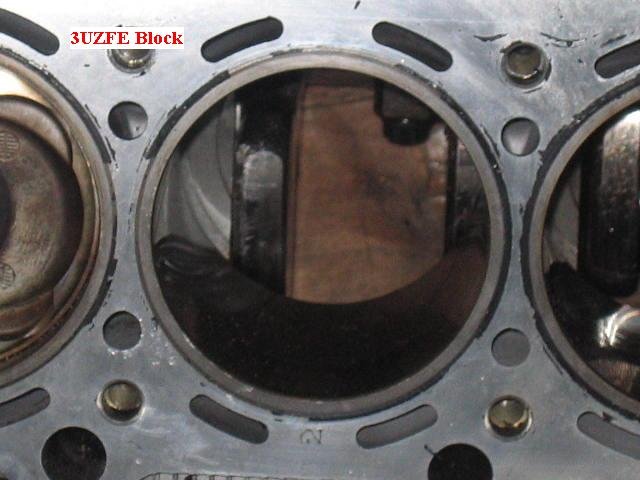

Here is a picture of the 3UZFE block from this site.
http://www.lextreme.com/3uzblock.html
This is with the stock 91mm bores.
The distance between cylinders is only 14.6mm.
When you try to run your 98mm bores you lose 7mm of distance between the pistons.
This leaves too little metal to support the forces that the gasket is trying to seal.
7.6mm is just not enough material.
