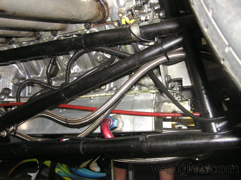

This is a solid block. Use mainly for short burst like drag. It has NO water passages. Solid block is very strong but can not desipate heat.

That is one piece of art. Great job Paul... Man of the Year 2008? Paul and I talk alot for the past year or so. He had a hard time with the iron block. I think he was making 1,200 to 1,400 hp before the block gave away. Now this block means business.

The Rockhampton boys are mates of mine and I take my hat off to them with their 4.0 ally block combo. I was there at the Summernationals and have the run on video. Remember they have being doing this for five years or more (and destroyed a lot of blocks in the process) and coming up into the tuning window on blown alky engines takes a while. They went 2 tenths faster just by one simple change - timing at that meeting. They are quick to remind me that they have 110 runs on this current block - good on them.
We have four full runs on ours. They have destroyed blocks in fewer runs in the past. Running safe and rich sometimes hurts parts in the beginning, but throwing rods out if you are too lean does more damage.
We chose more cubes just because we can :-) We will take ours to 300 cubes with a stroker crank after a couple of seasons.
We talked to Terry Sainty about the process of making a block. His early engines were three piece with removable cylinder banks, but his new design was one piece. He was just waiting for the chunks of ally which were hard to get into Australia.
