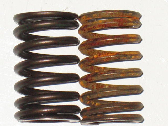

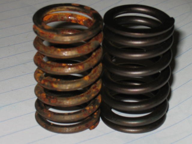

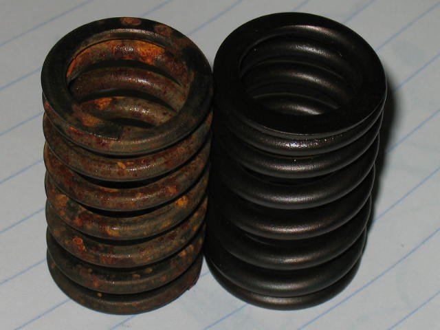

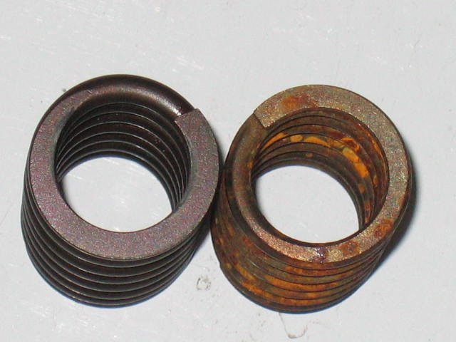

Since the ID and OD of the 2JZ springs are different,you might want to use the 2JZ retainers. You don't want those springs "wobbling".
What about using springs from a 2UZ or VVTi 1UZ/3UZ? If I have time @ work  I'll try pulling specs on those model springs.
