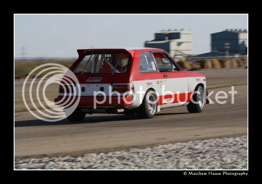

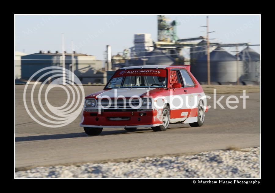

Looks like it will be quite the little beast. I love Starlets too, my buddy just purchased a ready-to-go track unit with full TRD widebody a few months back.
