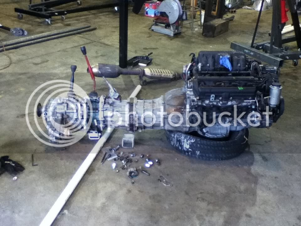

I bought thIs set up awhile ago. Got it mounted and mated to my dual Toyota gear driven t cases.
Now its time to deal with the throwout bearing ,fly wheel, ect

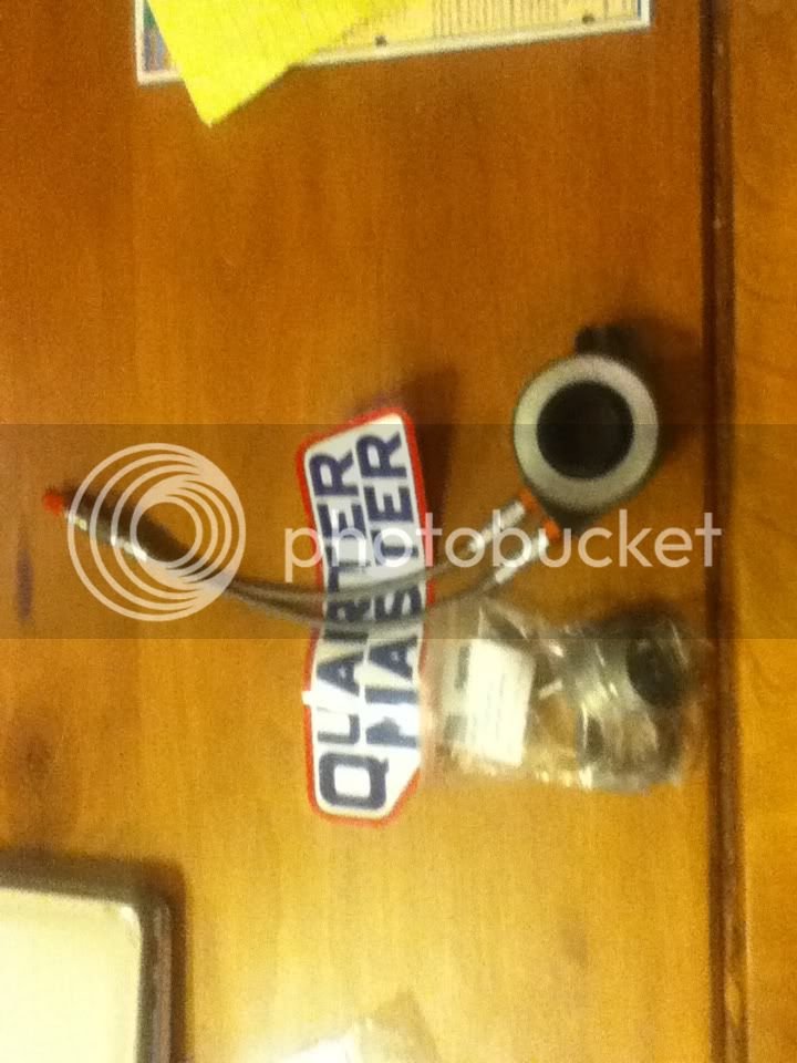

Okay sweet so I just need that throw out adapter then the Howe hydraulic throw out? This forum is awesome I expected people to be rude since I have no clue what I'm doing
do not use the howe bearing setup. IT WILL FAIL!!!
my adaptor uses the gm f-body hydraulic throwout bearing.
what do ou want to know? it sits on top of the adaptor plate and holds a throwout bearing from the t56 tremec transmission that's in corvette's and f-body gm vehicles. If you want a better explaination just call the number on my website some evening.

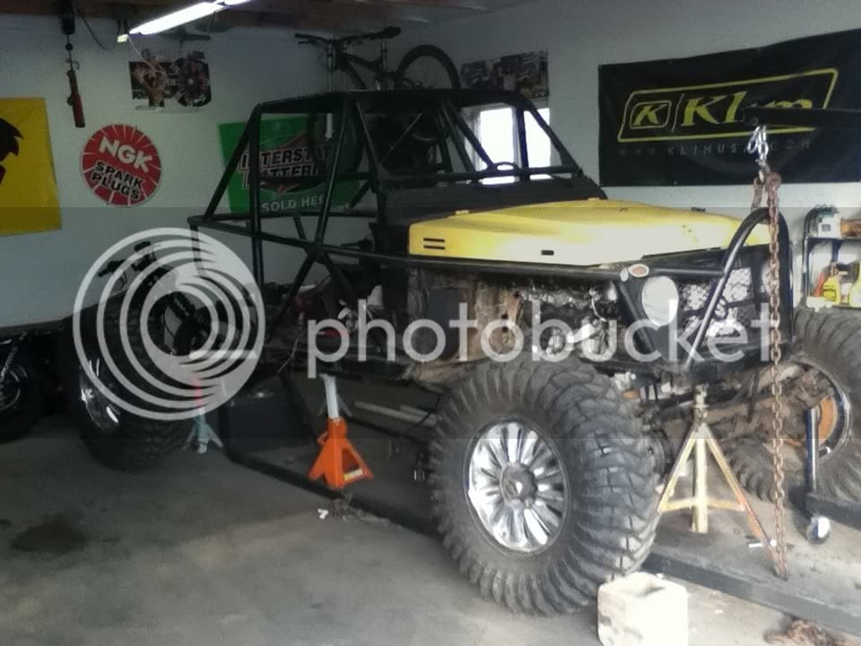

not much progress but the fall is finally rolling
been figuring out the front suspension!
really tight fit going into a samurai and trying to keep it low as possible but still have lots of up travel
toyotav8.com has been a life savor i finally know what parts i have he's helped a ton even though i only bought a fly wheel from him .
the time he has spent with me compared to the profit he made off me is crazy i recommend him to anyone and everyone doing a manual trans swap!
oh he even gave me the part number for the bearing that would work for my application even though its not a product he sales !
now just to figure out how it works
my clutch and master cylinder should be here friday

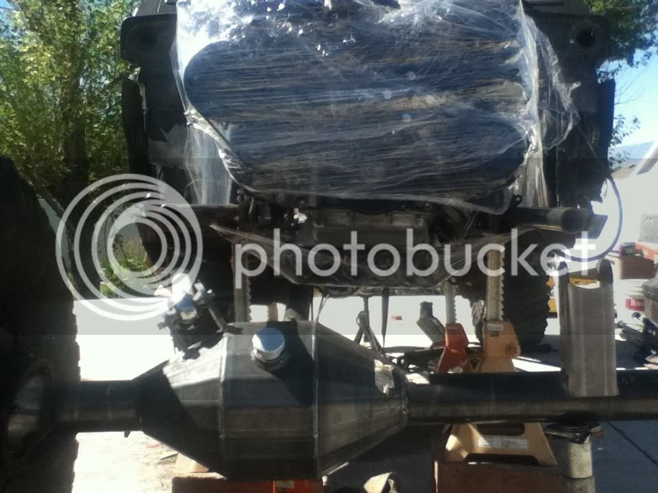

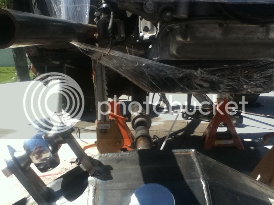

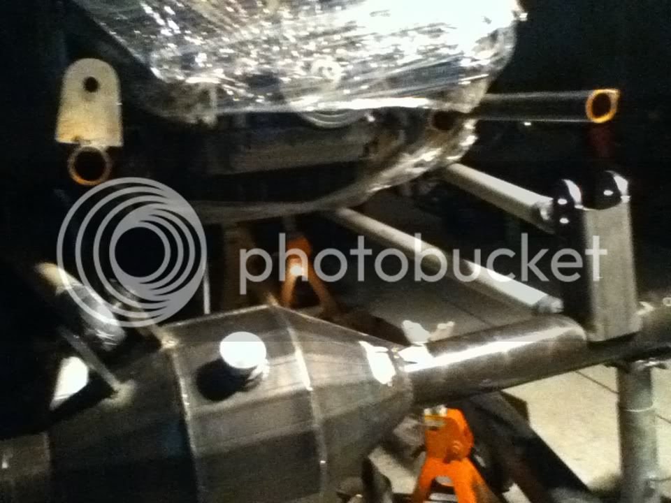

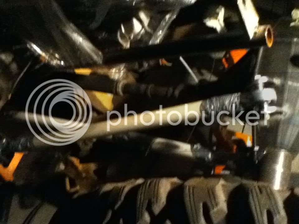

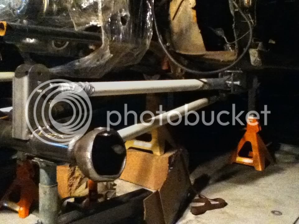

maybe someone on here is interested in how big of pita it is to make good suspension around a 1uz in a suzuki samurai frame with limited fab tools and skills

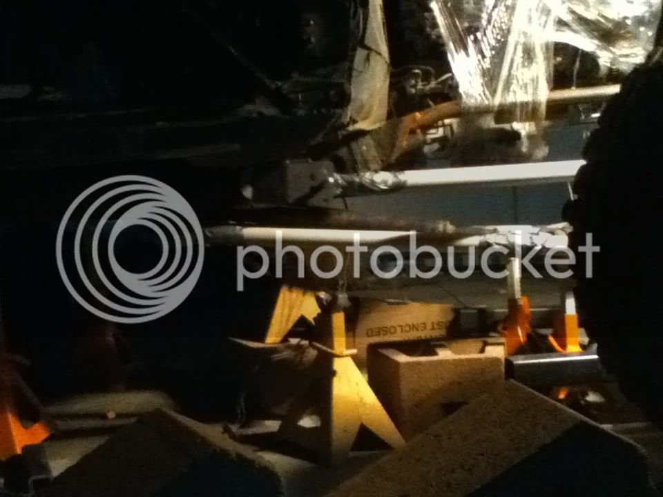

not much progress ..
sorry pictures in the dark dont work too good
axle vertical separation
triangulation
vertical separation at frame and adjustability
someone is looking...
