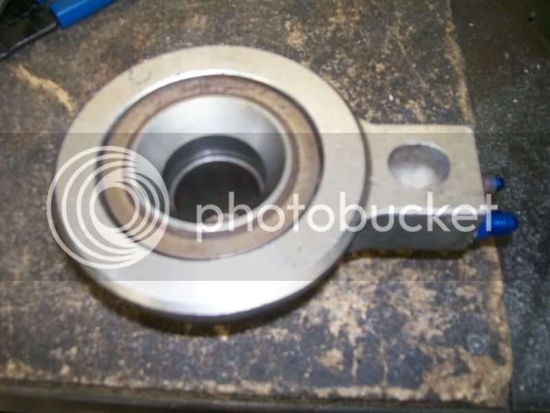

here's the QM unit. I'm not sure what model number it is off hand.

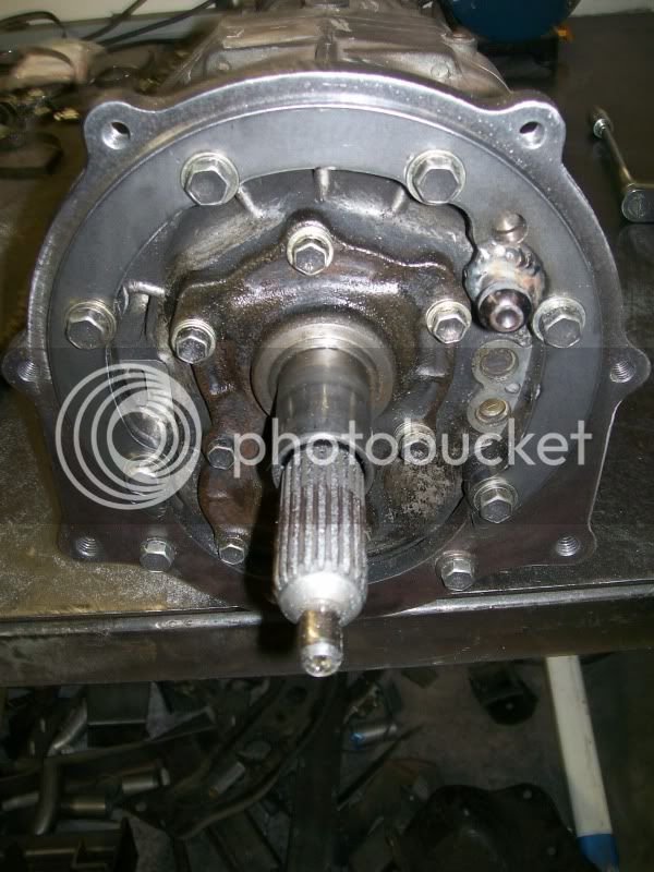

W58 with a random adaptor plate..... lol

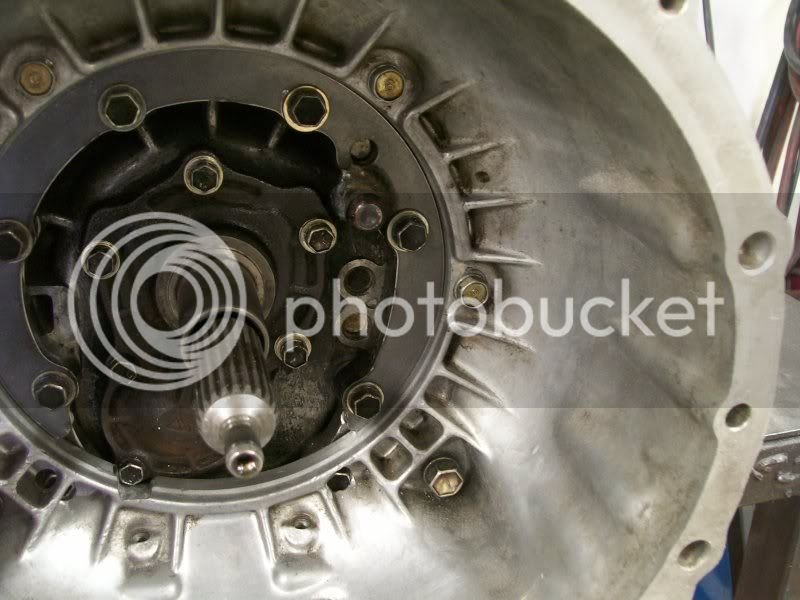

bellhousing modified

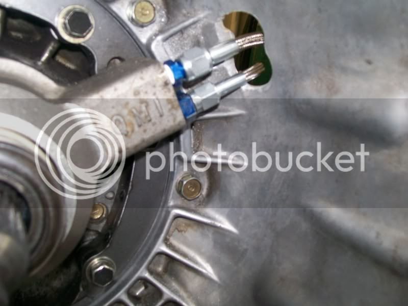

note the washers under the bolts for the front bearing cover plate. he used the heads of the boltd to rest the quartermaser unit on. I had my doubts, but he's had 0 issues and he drives the piss out of the car on a daily basis.
the ball for locating the QM unit was welded to the steel plate.
