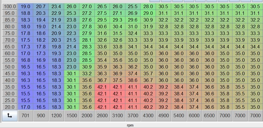

I'm running a Megasquirt MS3/3.57, and its performing great. I have several stages of plans, so needs are going to change. I'd like to get people to post their timing settings for whatever tune they have, regardless of ECU. If you have had good luck with it, post it up and help create a resource. If anything is different about your settings, post that as well, along with what fuel you are running.
Here is what I am currently running. Not optimized in any way, but working for a year now.
92 sc400 donor motor, stock. Sea level, 92 octane (R+M/2), very restrictive exhaust.

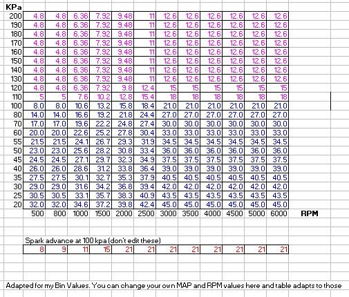

And here is the reason for the thread. I used an excel spreadsheet timing estimator, and the numbers are quite different then what I am running now. I know timing is fluid, an two engines off of the same assembly line will have different requirements, but everyone has to start somewhere.
