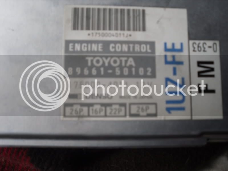

What ECU number / pin configuration?

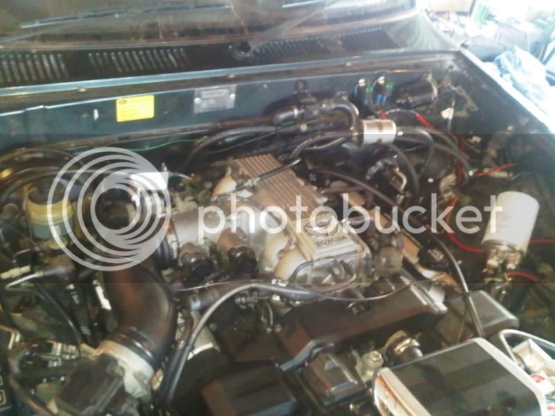

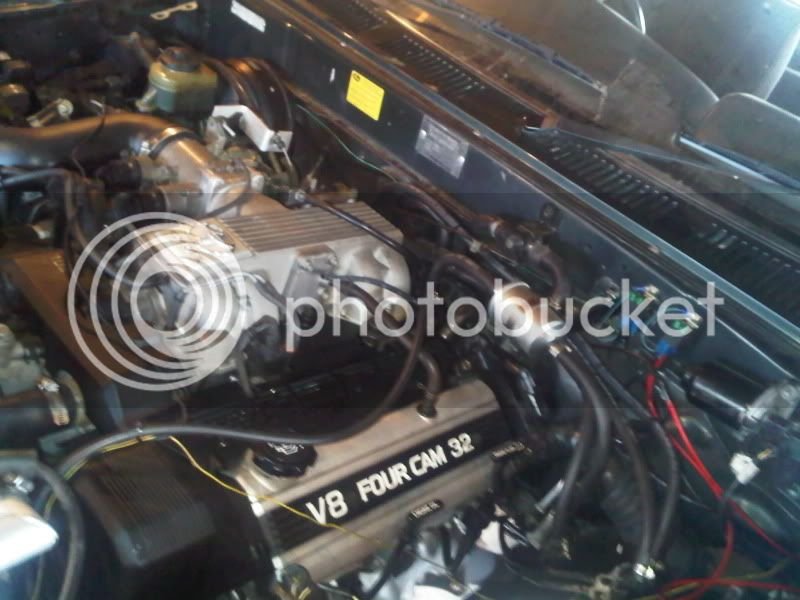

Can you take a couple of photos of the engine bay and post them up so we can see if there is anything basic connected incorrectly on the motor.

ecu model was in other topic u read old afm with bolt-on intake
