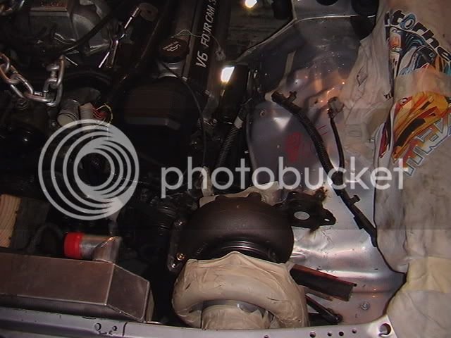

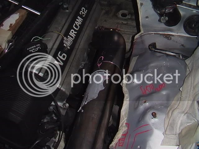

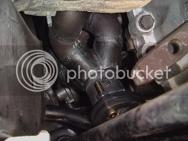

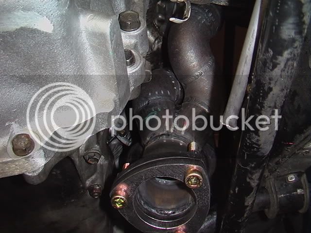

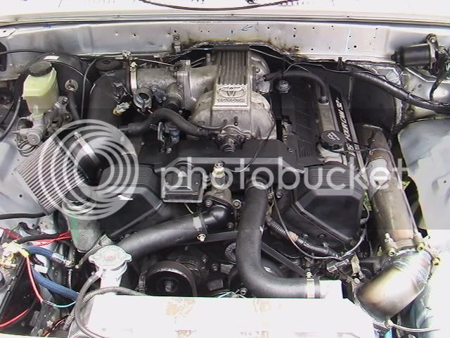

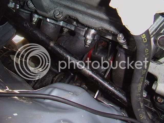

it still not finished obviously, the wiring needs tidying, and i need to put in one more bit of sheet metal under the exhaust, just to name a couple of things. anyone got a cheap gt42r?we used my brothers spare turbo whic hhas the exact same exhaust housing as the gt42 and mocked up from there we dubbed the pipe that joins where the turbo would be and the exhaust "the lunchbox" for some reason or another. it will do the job though and hope fully if i have to do a long trip in the future and dont want to be boosting and using alot of fuel i can just bolt in the lunchbox change maps and away i go.

i had a turbo lined up but it turned out to be a shitty ebay jobbie so we dummied up where the turbo will go with a spare turbo my brother had lying around which has the exact same exhaust housing (1.06 on a t76) as the one i will be using (gt42r). its another $2500-$3000 just for the turbo so i will wait till i get the rest of the car sorted before it goes on. i already have bigger injectors/intercooler/eboost2/turbo timer/waste gate etc so hope fully not too much more has to be spent.
oops, bellhousing is from dellow (crap quality though it works fine). clutch is a 5 puck ceramic skyline job with 2800lbs clamping force. clutch slave is from an early hilux,

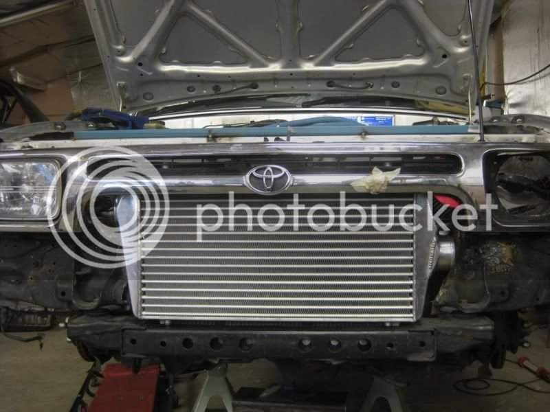

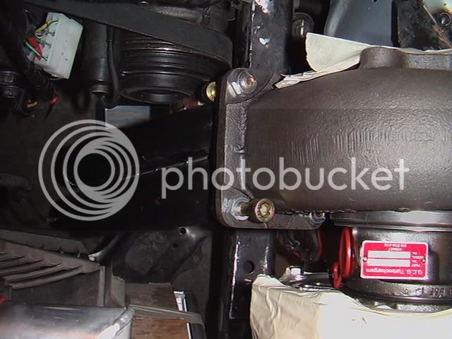

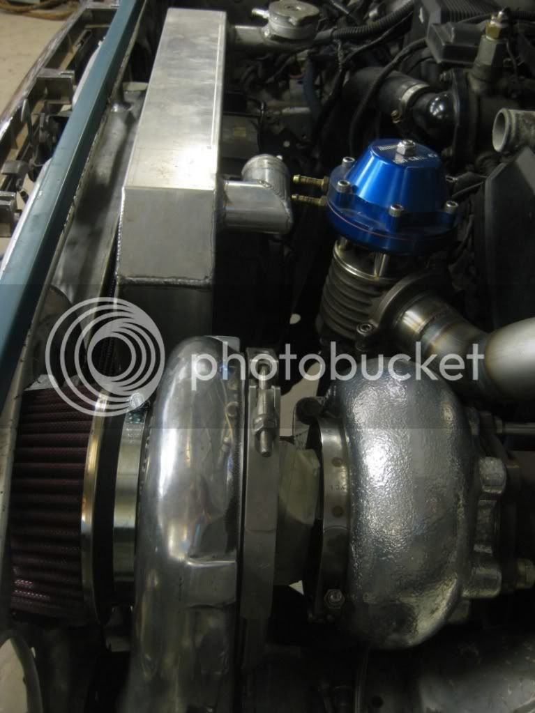

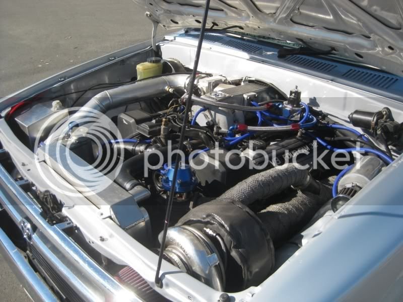

update time, turbo/gate is on, cooler is mounted.

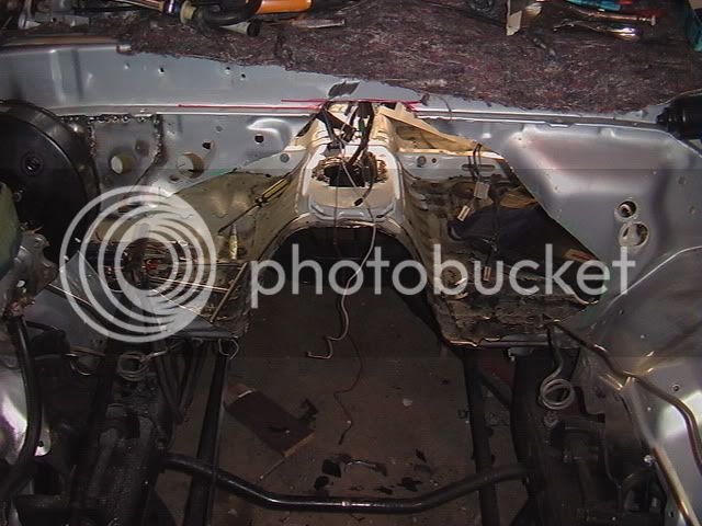

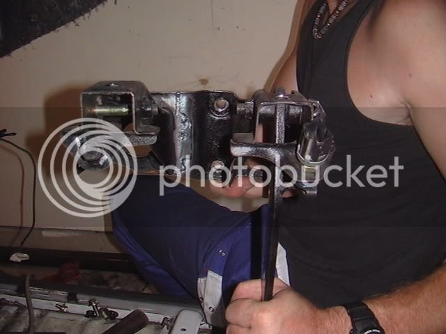

but the biggest drams we have just found is that due to the engine sitting so far backwards, theres not enough room for the auto or any auto that will take decent power (exept a glide which isnt happening).
crossmember for those who dont know is welded on hilux's.
so the plan is remove torsion bars (done), fit coil overs and notch the cross member. bit of a fuck around but its going to be the same with a manual or any decent gearbox that can cope with the expected (hoped) power output.
dave seems to think its an easy job, which for him it probably is.

had it tuned for e85 a while ago, but was blowing the spark out pretty hard by the looks. still made 310rwkw on 15 psi which wasnt too bad.
