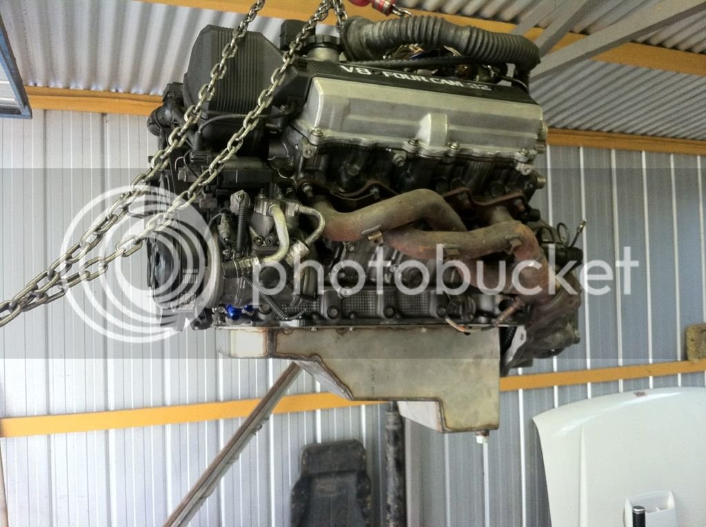

G'day guys. I have a 1uz that I put into my hilux that I have fabricated a custom sump for. My question is. Can I drill a hole and use a mid sump dipstick (through block)? Or are the blocks not the same? I can see the blank boss where the dipstick would be?

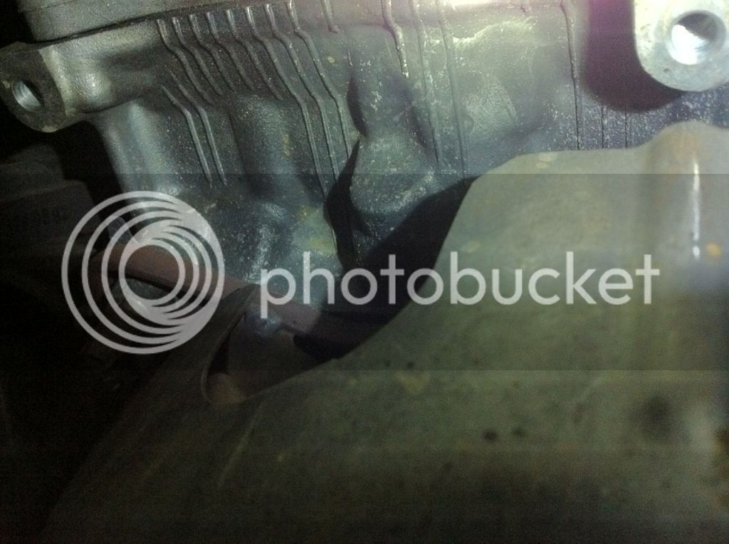

Don't know if my block is the same then. It isn't a "plug" as such. Just a blank area in the casting. I'm thinking if I drill through I will be in to the gallery that runs to the sump?
See picture attached.
Here is that close up. If I can help it I don't want to have to take the sump off again. Requires pulling the motor.
