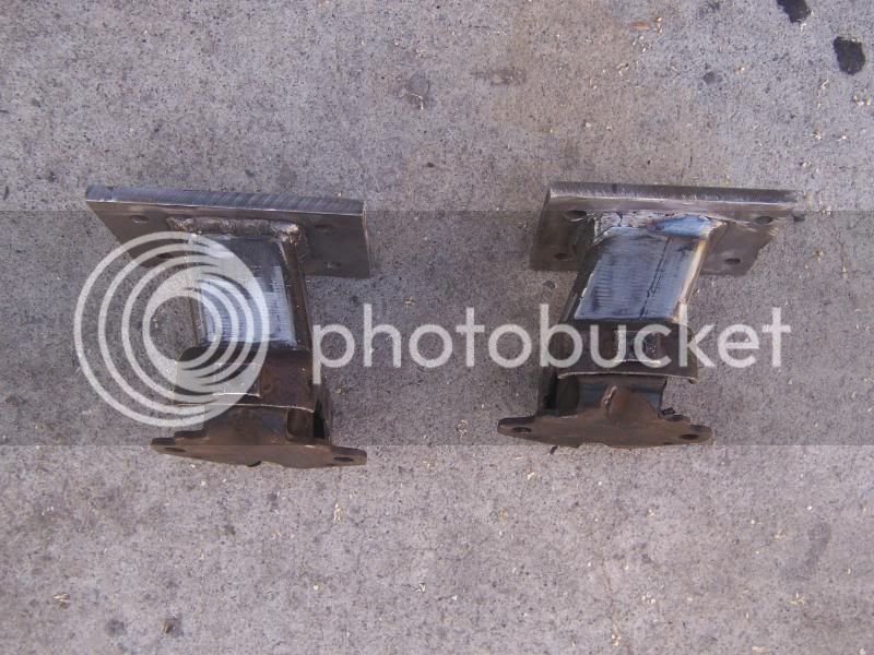

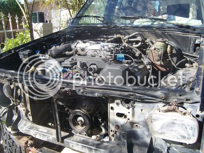

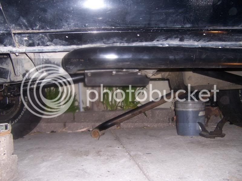

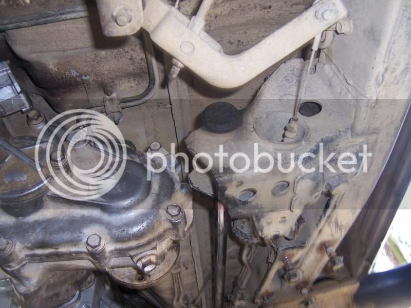

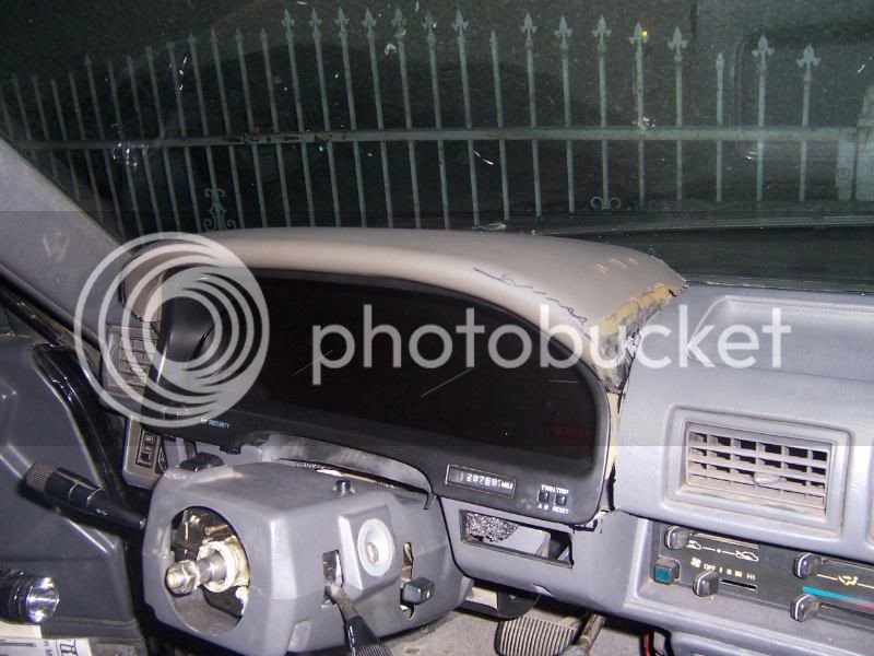

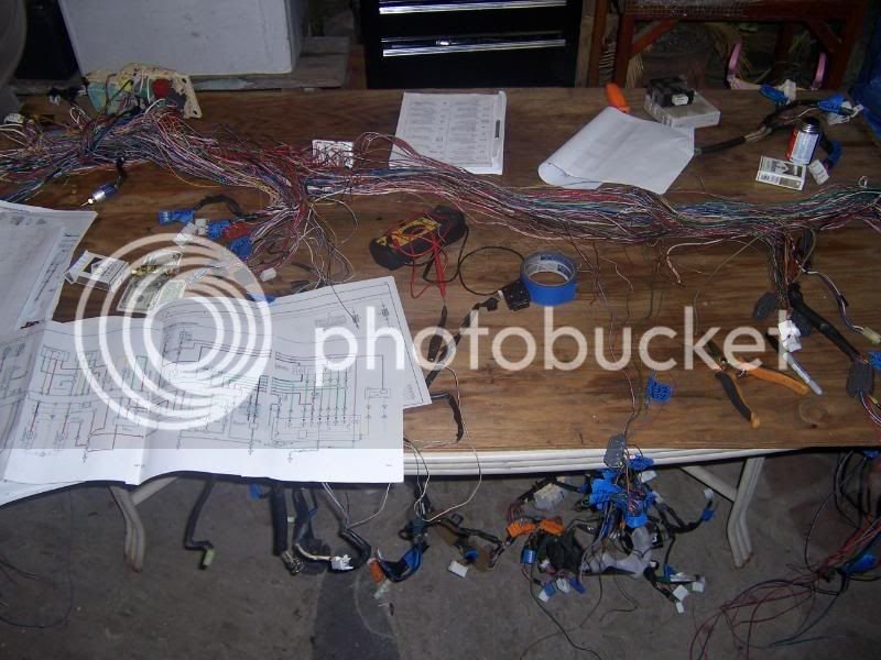

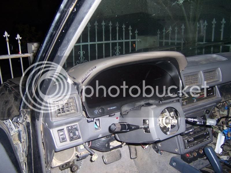

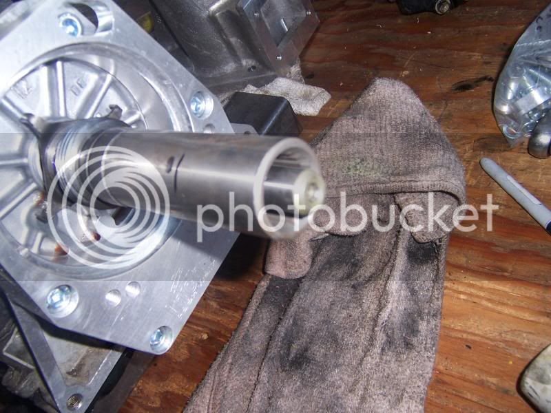

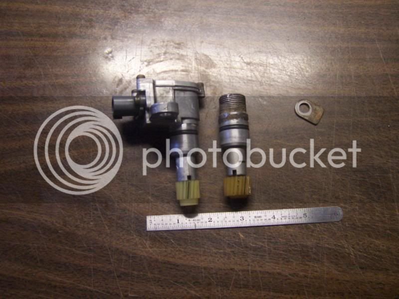

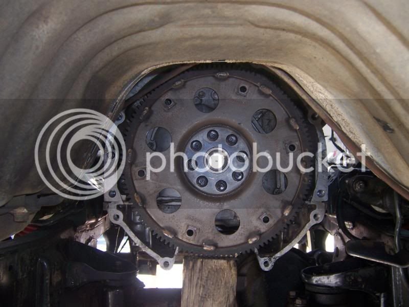

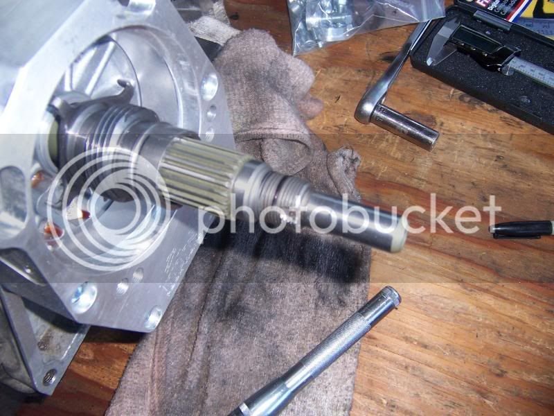

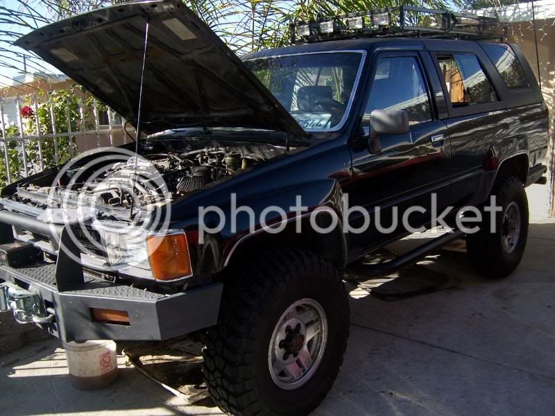

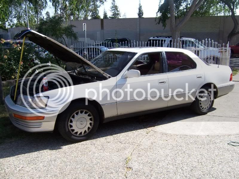

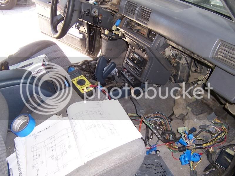

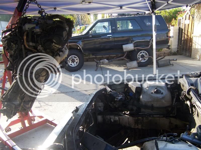

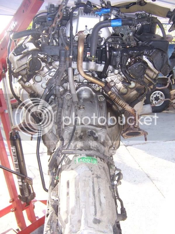

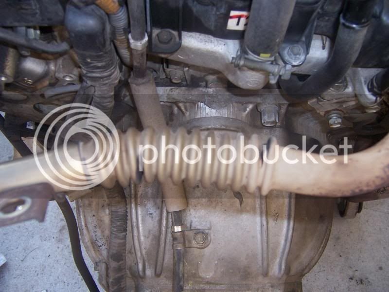

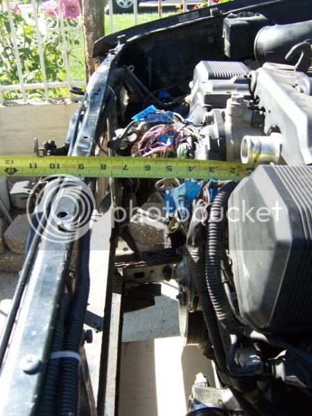

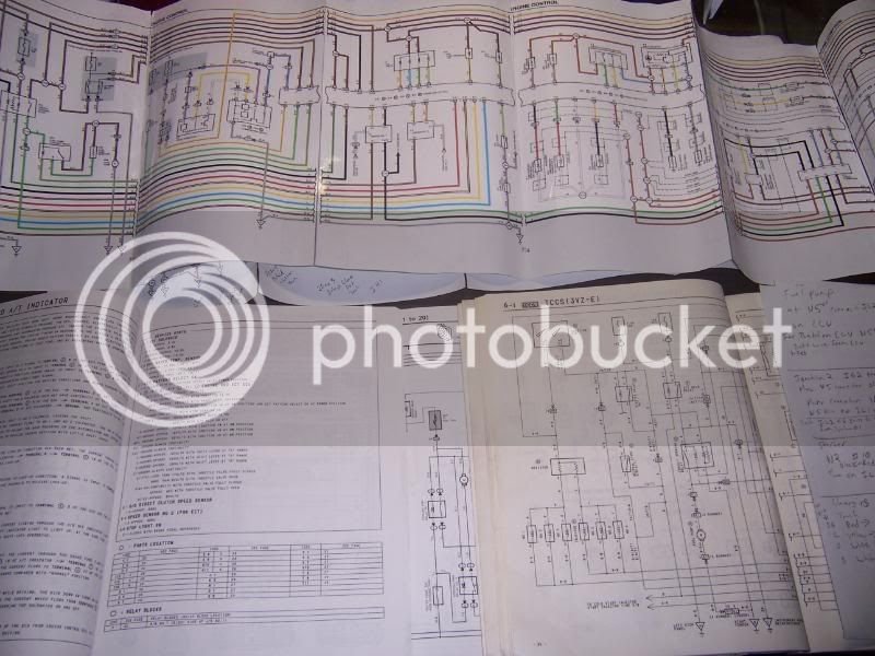

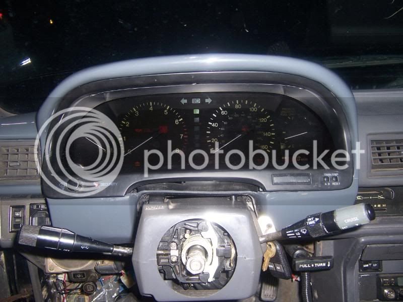

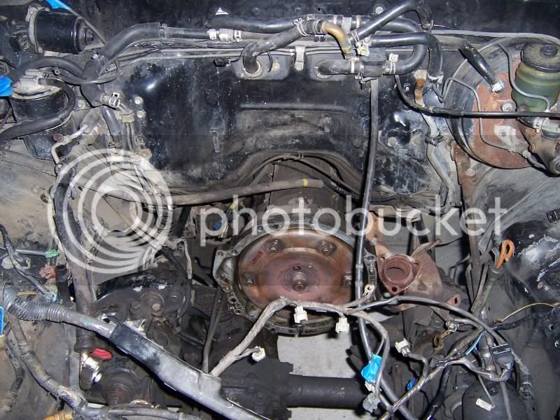

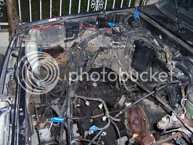

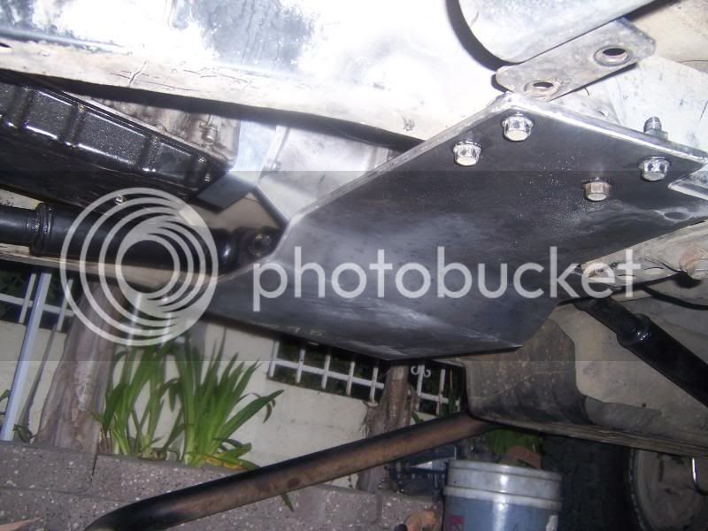

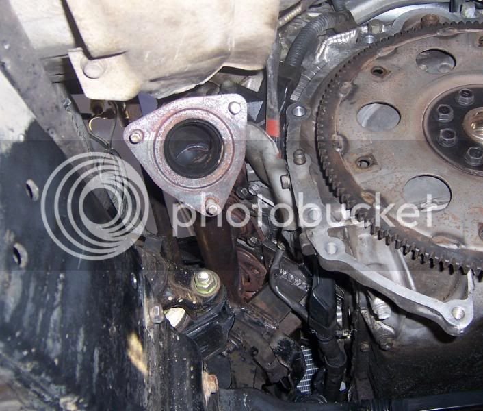

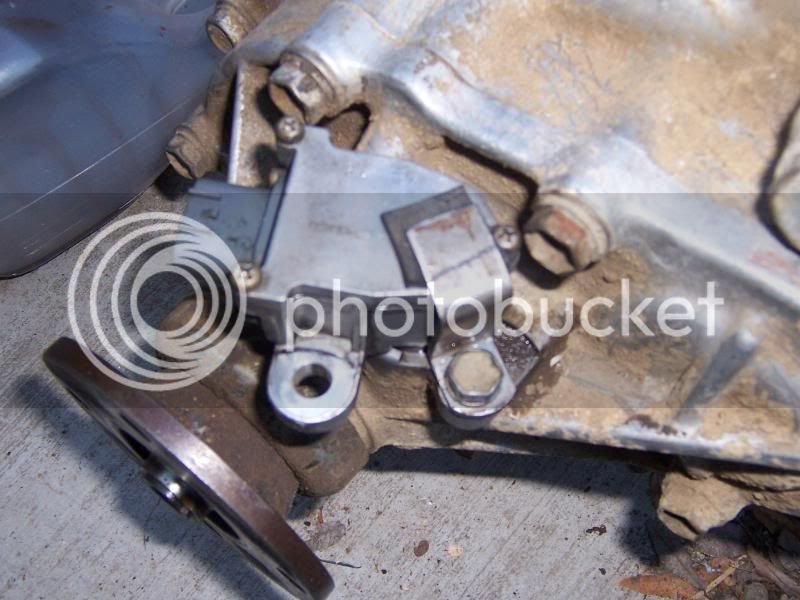

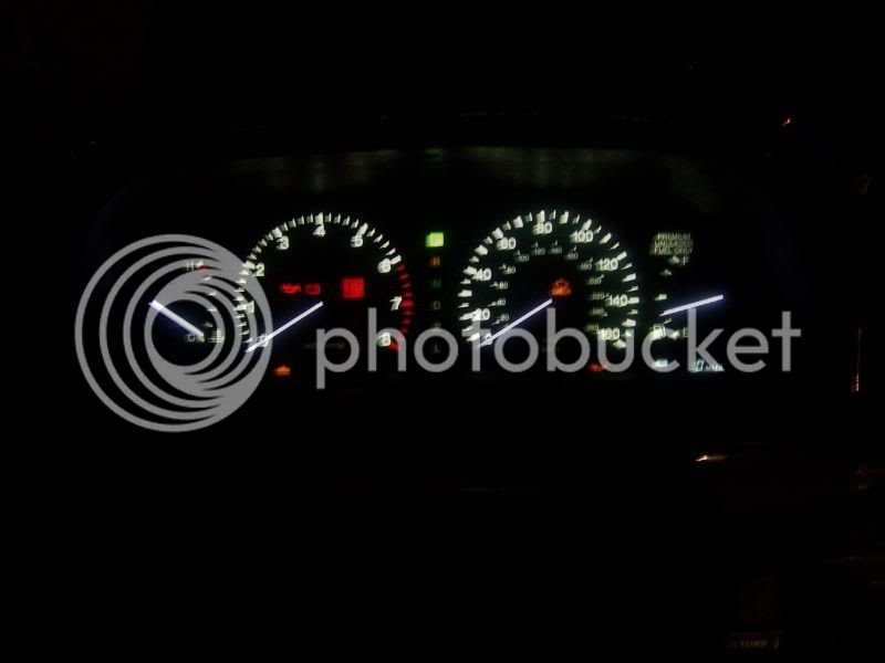

1uz into a 1988 4runner
BY the way this is what I used .
1UZFE

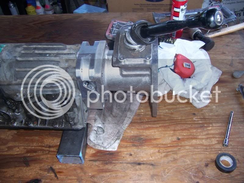

A341E

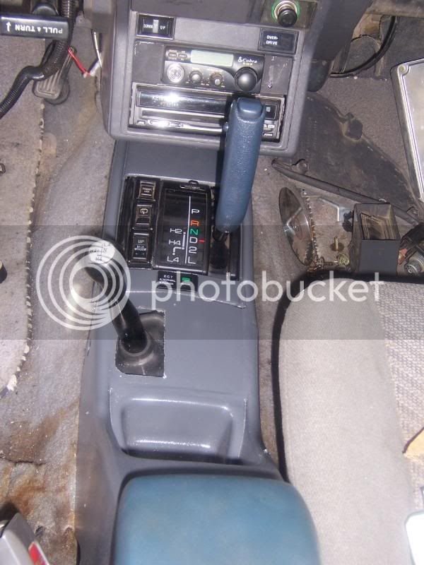

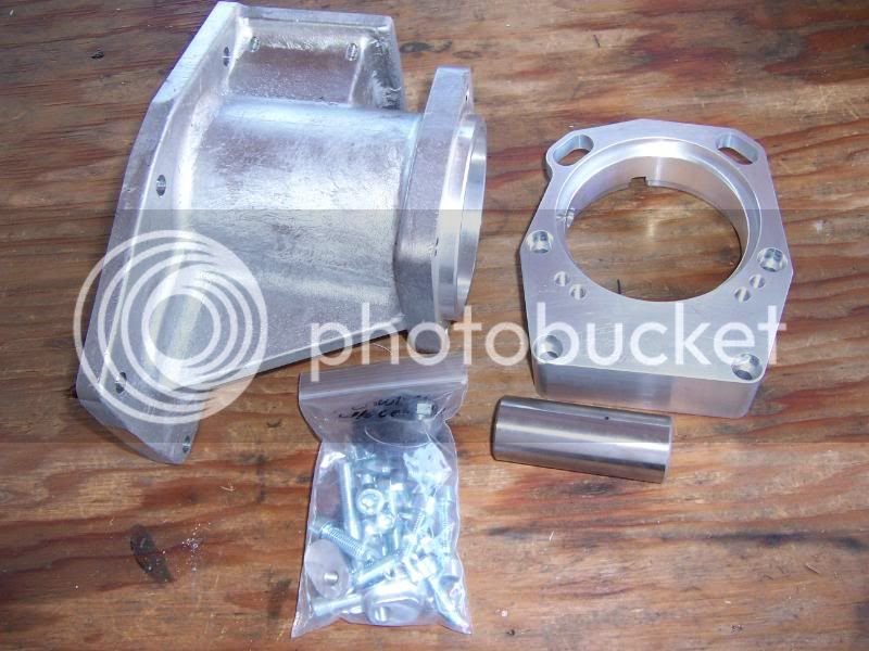

Prerunner adapter www.inchwormgear.com #300-0052
21 spline gear case

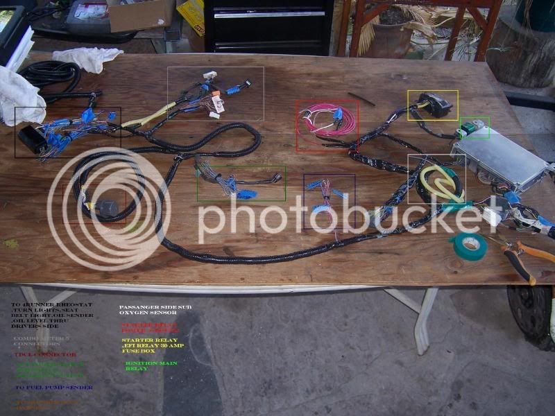

accessories from ls 400

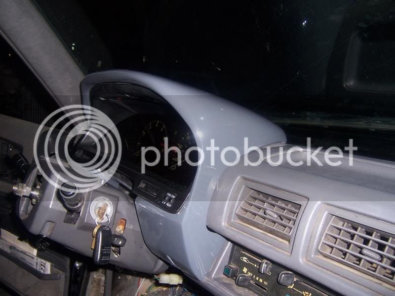

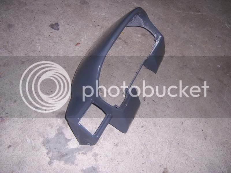

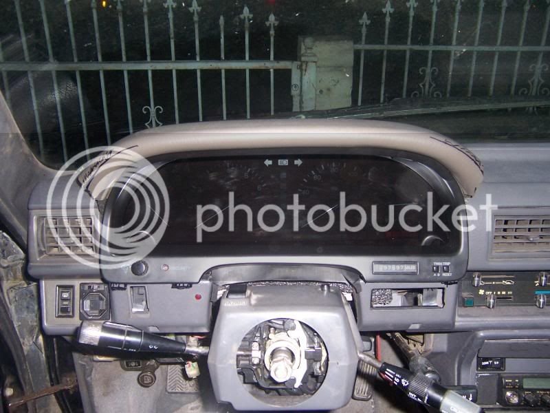

lexus cluster

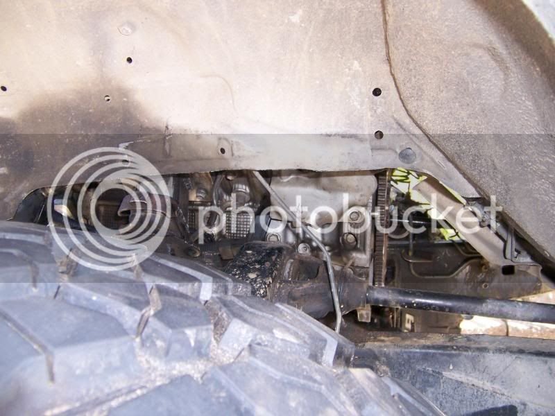

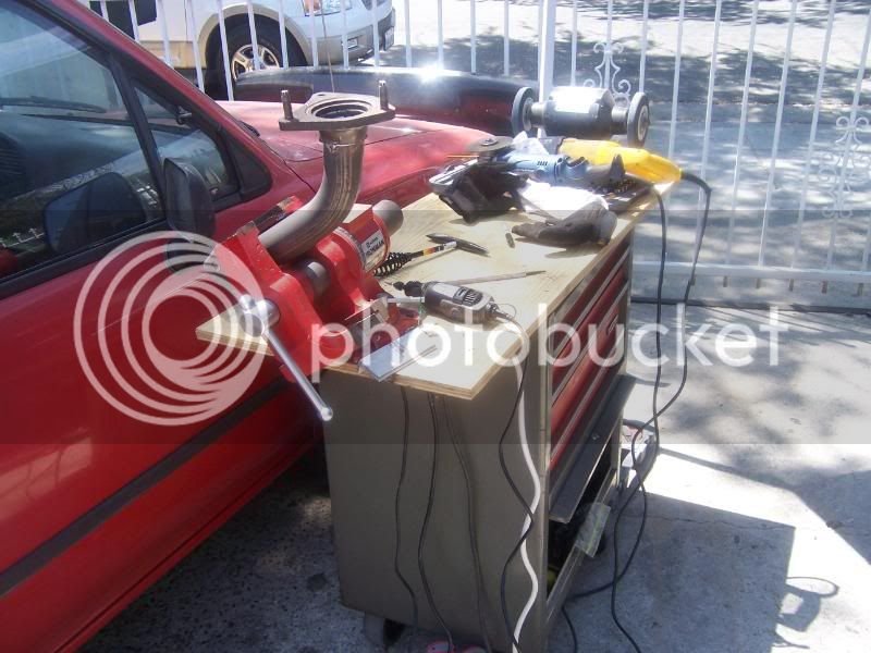

Home made motor mounts.

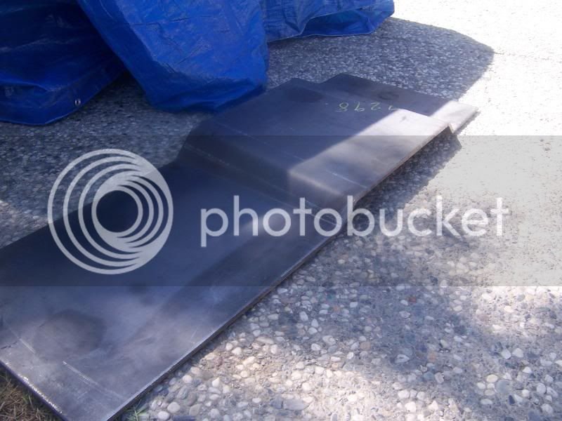

Home made crossmember
ls 400 fuel pump.
2003 tundra exhaust manifolds ?

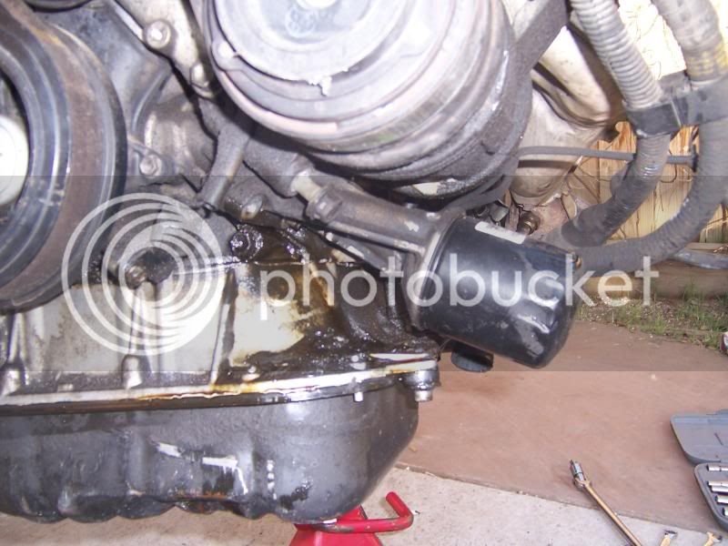

2003 tundra down pipes

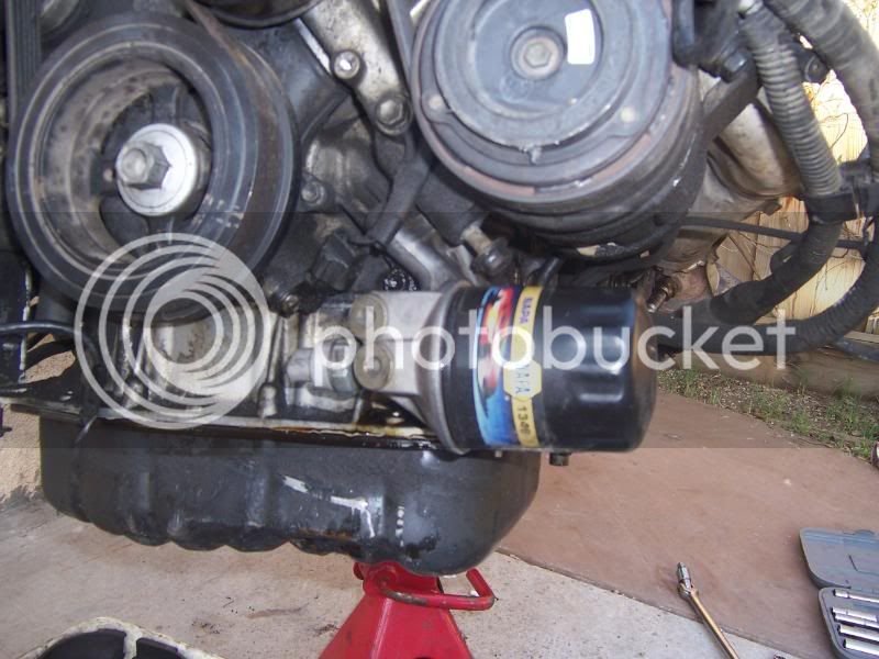

sc 400 oil filter Housing

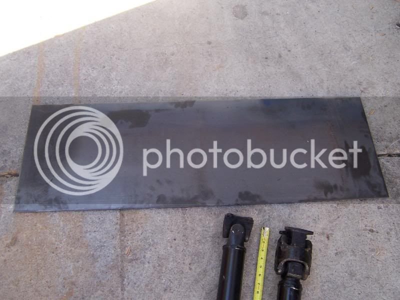

Rear drive shaft shortened 5 "
front drive shaft extended 5"

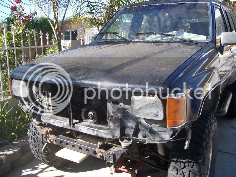

Hey guy, I just checked out your thread over there. Looks pretty damn functional! Just need to do some fine tuning and detail work and that rig will be super nice. Good work.
Thanks smithers, your build was the final push for me , great work on yours .
I do need to button up some things but so far eveything is working fine .
I wish I could afford to make it look pretty but , Im ok with just having it work .
Good luck on yours , love the colors of the engine.
Its time to get it dirty or Dirtier and tear it up.

My hydraulic throwout bearing conversion was a huge setback. It's not that hard BUT you have to drop the transmission 5-7x to get it right. I remade some spacers out of aluminum recently and it should be going back in for the last time this weekend. blah blah blah then I'll be 100x closer to starting it up.
