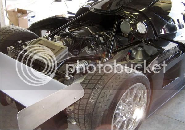

The turbo kit Fran (SLC Designer) has from his original 1UZ was designed for Non-vvti and so if I want to go TT down the road, it would be bolt-on basically.
*See attachment for his TT-1UZ*
