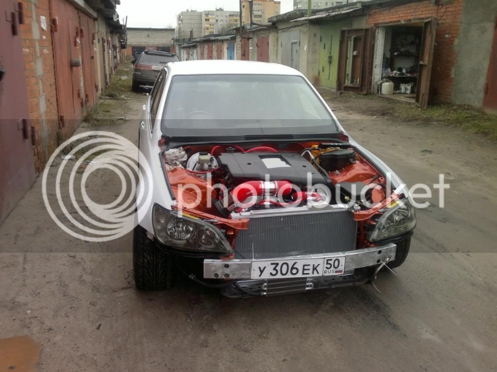

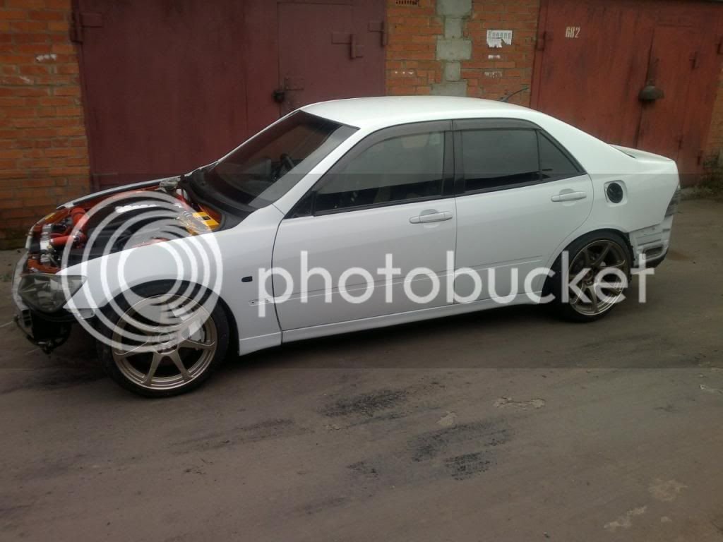

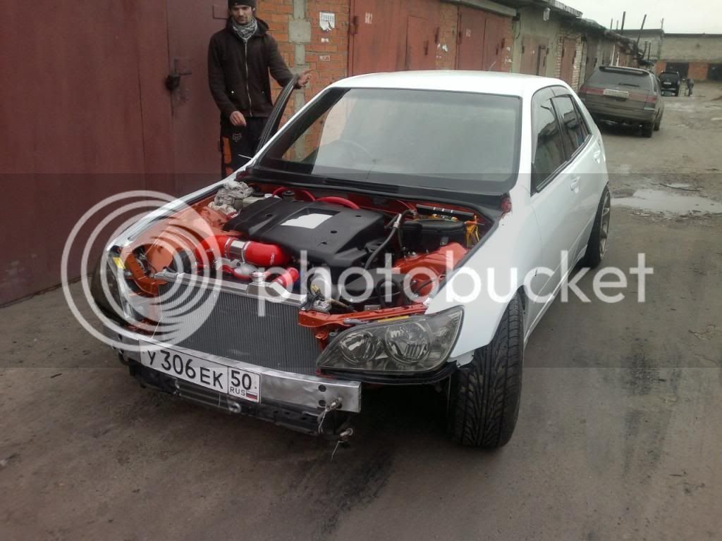

hey all. My name is Evgen and i'm from Russia. I'm a huge fan of V8 in general and 1uz-fe especially. Sorry for my english, i know that's really bad but it's not a big deal, right?
Let me introduce my SXE
It was almost full stock 2001 3s-ge tezza with mech gearbox.
i bought it and ride through six months. one day i thought " she is not as fast as earlier for me, and i'm sooo like american muscle cars with those bid and sexy engines, why not ?
Two years later i got this :)
sSCb0d153BY_zps3113dbdc.jpgOWkAroOl81k_zps8e0f92a1.jpg0JtKoGOP49c_zps3322e300.jpgyr7LbEnv-pw_zps8b698330.jpg
specs:
  • 1uz-fe vvti from crown 171 majesta
  • j160 gearbox stock altezza 3s-ge
  • 3s-gte clutch from caldina st215
  • release bearing 1kz
  • custom exhaust with 2x63 pipes
  • 50mm engine radiator "chinapower"
  • full repaint
  • front brakes with 6pot calipers from porche cayenne and 355\32mm rotors from is-f.
  • rear brakes with adapted stock calipers and 307\16mm rotors from aristo 161
  • CST Hyperzero wheels 9+30 front and 9+23 rear
  • 225\40R18 infinity tyres
and a lot of other things :)
more information and pics later.
please- ask me your questions, i'm wanna improve my english and share about my car with you
