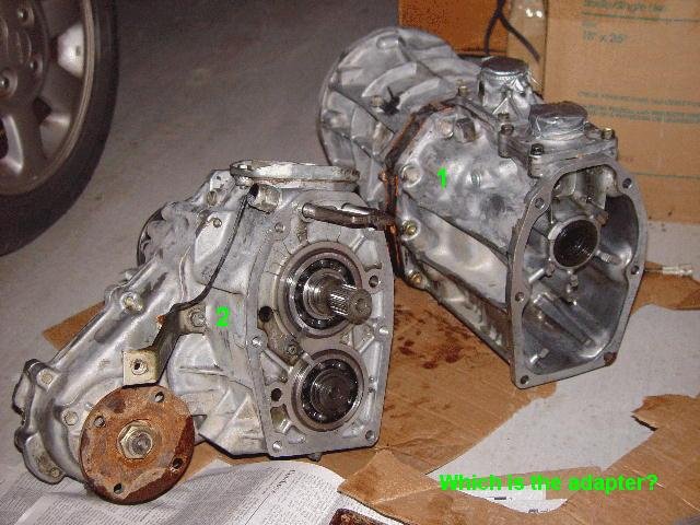

As far as I know ALL transfer cases that came in a IFS hilux are chain driven, I have to run the gear driven case as I have rockhopper low range reduction gears in my transfer case.
Guts
In Oz yes, but the 1986/87 US Toyota came with a 22R EFI which was fitted with an R151 and gear transfer. They are available as I tracked one down and had it shipped. You can see the gear transfer etc.
You can then use the stronger R151 series trans which combined with your rockhoppers and a 4.31 1st would give you good gears.
But you could use the G52/W series Dellow bellhousing ($495) if cost is a consideration but IMHO the G52 will break and much better to start with a stronger trans.
I am just going to use the G52 for now as I have 2 of them here, I know I WILL break them but it don`t bother me that much. When I have broken the second one I`ll go to the stronger box. I am going to use the Castlemain Rod Shop adaptor as you can modify it later (meant to be easy) to take the stronger box. With dellow I have to buy a new adapotor.
