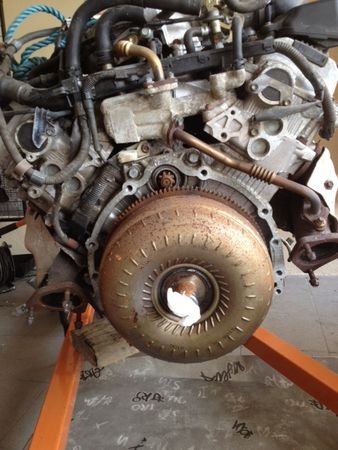

I am trying to gather the information necessary for my project.

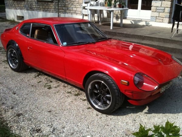

I have a DATSUN 260Z 2 +2 and I want to replace the current engine, a cast iron L26
So I go for the 1UZ-FE in England because the models have not had the LEXUS 1UZFE have not been sold in France.
So I found a 1UZFE from a Lexus LS400 UFC20 1994-1997
The engine-inc engine loom, throttle body, distributors, starter
+ Auto gearbox
+ Torque converter
+ Alternator
+ Engine ECU
+ Engine mounts
+ 2 X Catalytic Converters
X + 4 O2 sensors
Y + front exhaust pipe section
+ + Prop Mount Rubber coupling
Gear selector unit + + sunrise
+ Complete Front loom
+ + Relays fuse boxes intact
Now that I finally have the engine, I realized that I need a rear sump SOARER/SC400.

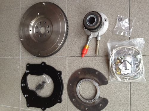

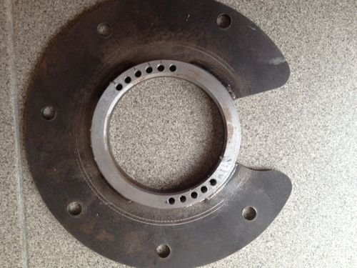

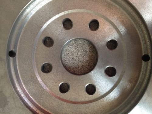

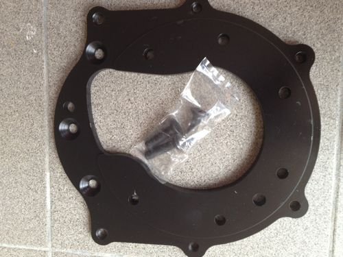

All just the adapter kit to fit the V8 manual transmission on a LEXUS TOYOTA supra W58 from 4U2QUIK
description of the kit:
A flywheel 3VZ-E (3L V6 TOYOTA 4RUNNER) change
A wedge adjustment to tailor the bell box 1UZ-FE Automatic on W58

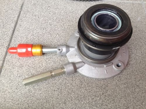

A hydraulic stop T-56 to control the clutch
A wedge adjustment to adapt the hydraulic stop T-56 on the box W58
And of course all a set of hydraulic hose to the stop and mounting kits.

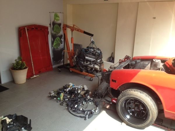

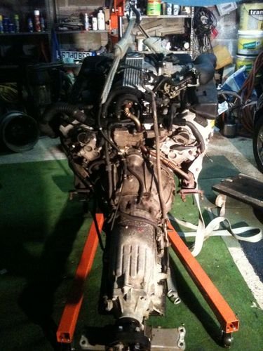

The place is made​​, so I could bring the V8 at home.
He is waiting for that one takes care of him!! Soon, soon
But before I deal with another party.

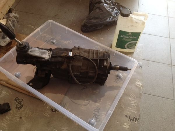

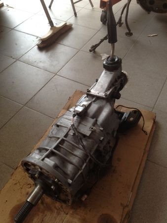

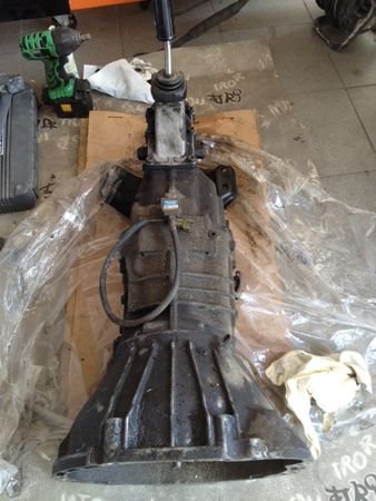

A manual gearbox (W58) Toyota Supra MK3, in its own juice ...............
It is not very clean, so little cleaning session.
But before I take off the bell above which I will not.

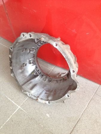

Another item awaiting his turn: the bell of the box Automatic 1UZ, necessary to assemble the manual transmission
