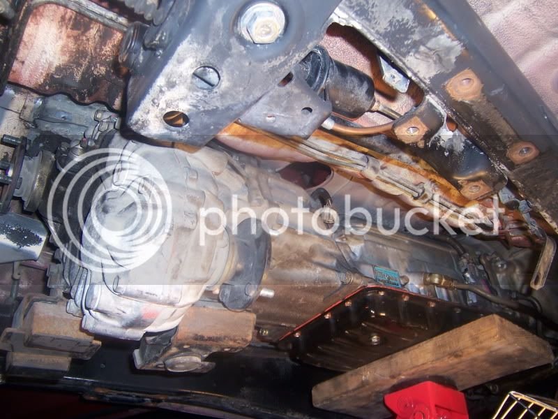

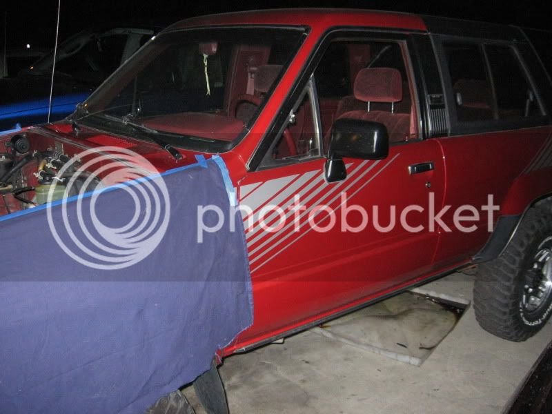

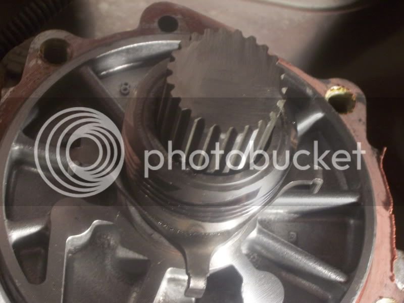

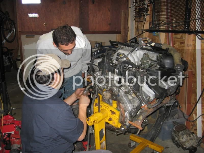

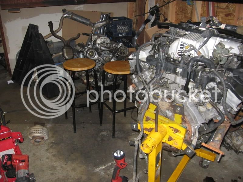

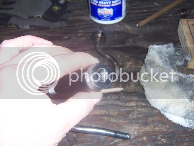

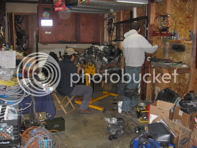

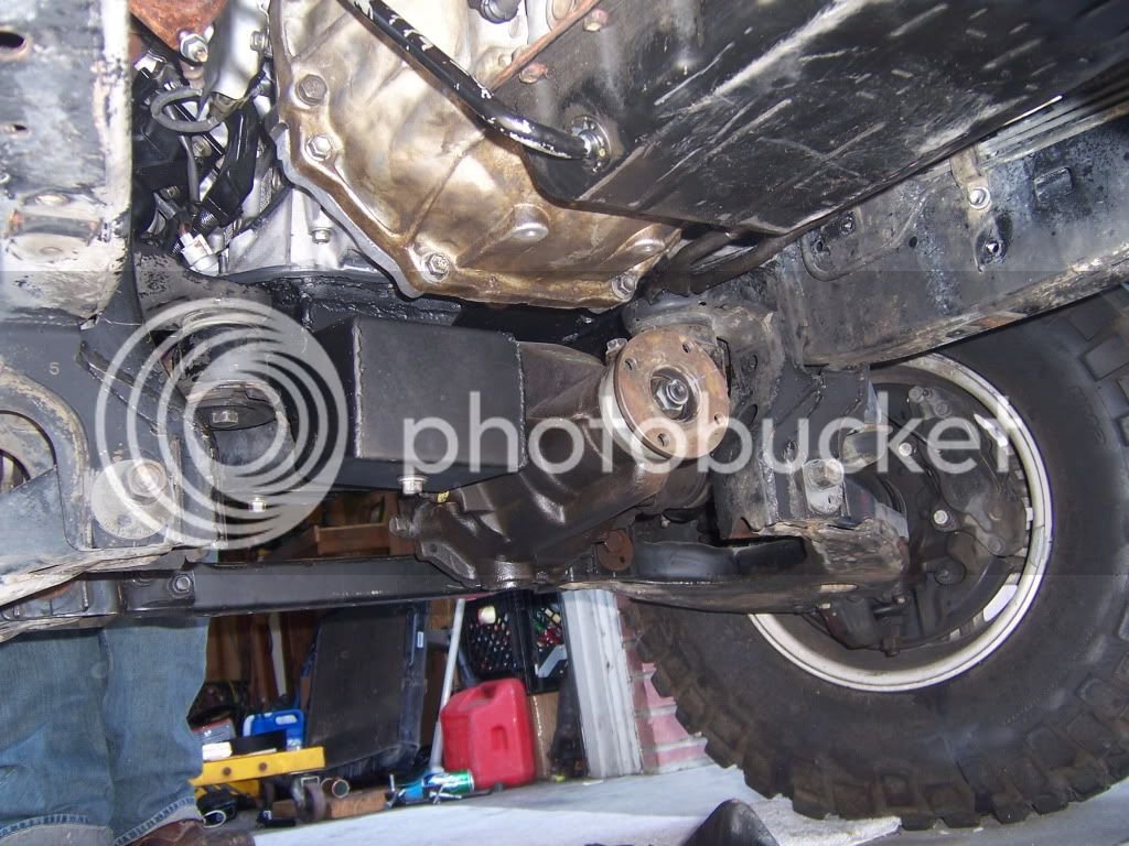

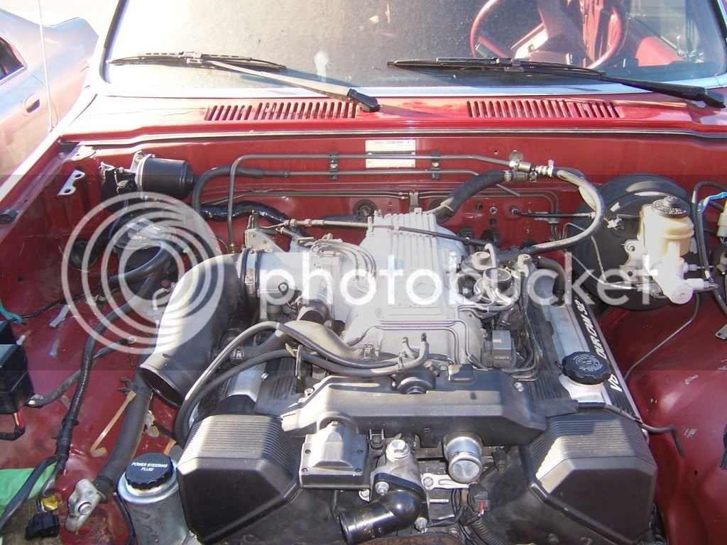

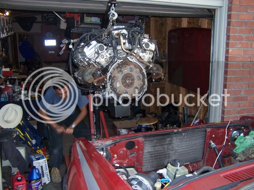

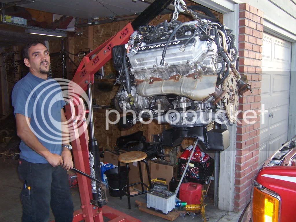

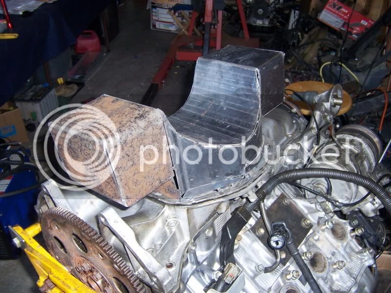

ok so ive started on another swap .. we were waiting for the 3.0 to sell , finally did so now onto this swap.
So the owner of this truck wants to try and do this with out a body lift , so well be lowering the front diff and modifing the sc oil pan .
wants to try and keep a/c and cruise control.
will be using the following

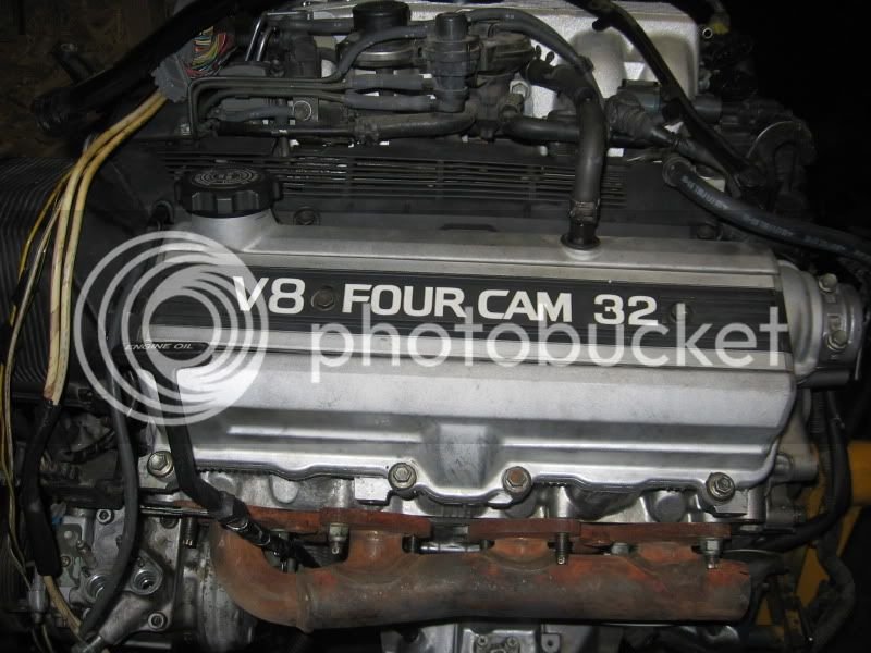

1992 sc400 1uz (modified oil pan)

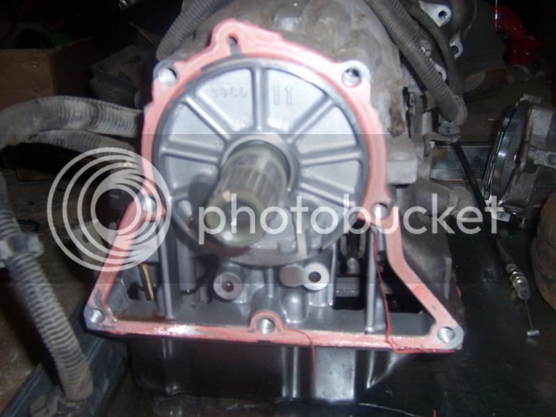

1992 ls 400 auto tranny
inchworm prerunner adapter
no body lift

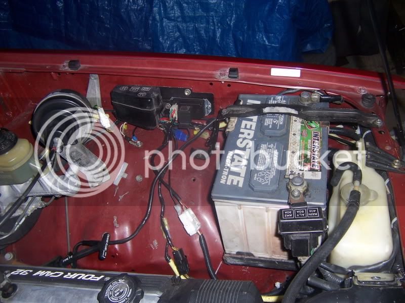

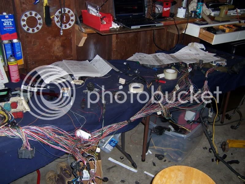

DIY wiring
SC 400 cluster
2001 tundra exhaust manifolds

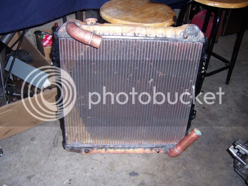

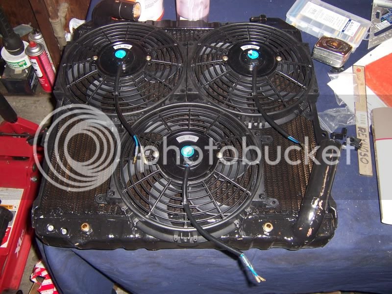

3.0 radiator modified with 5 row core

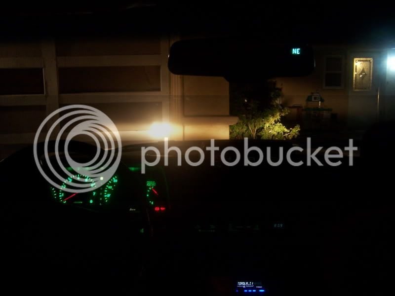

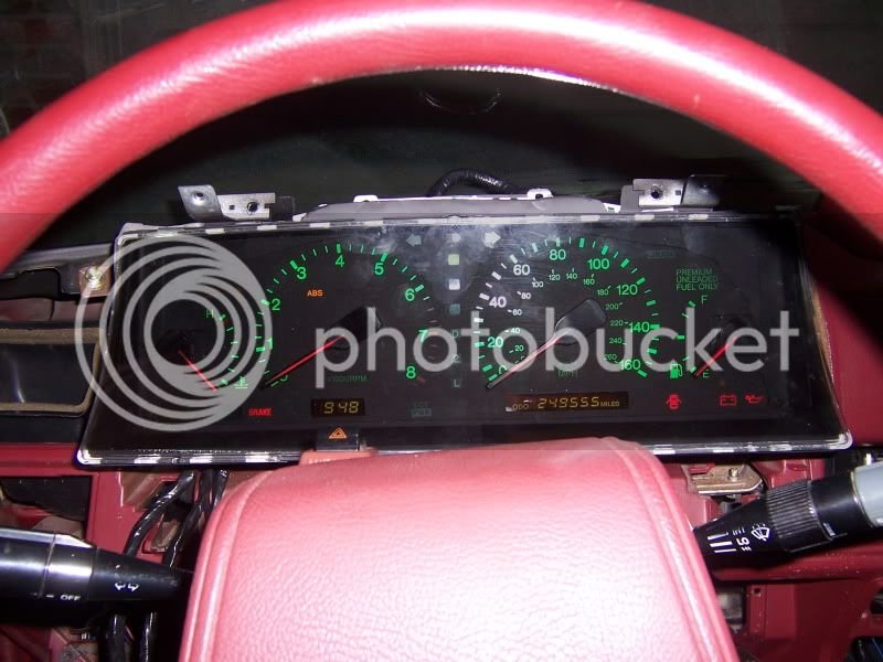

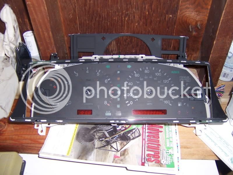

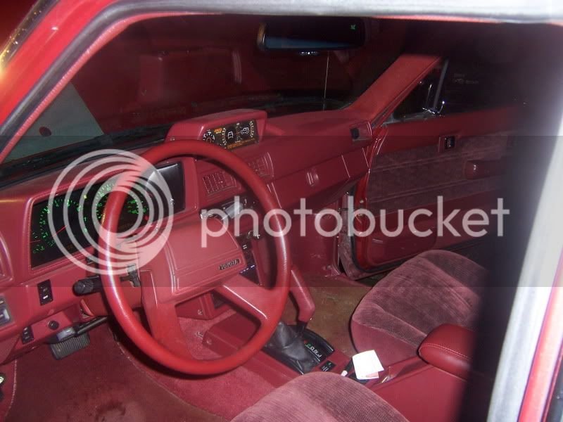

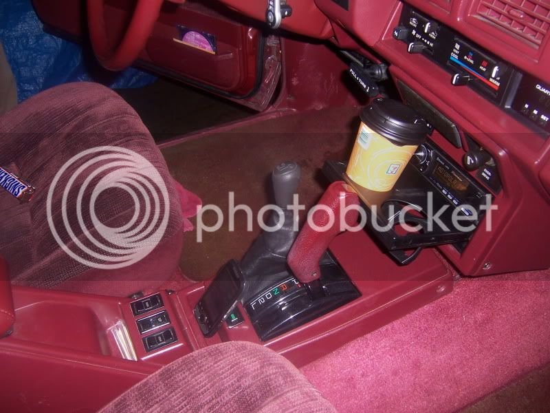

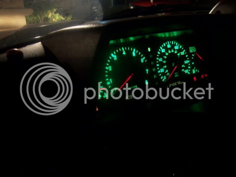

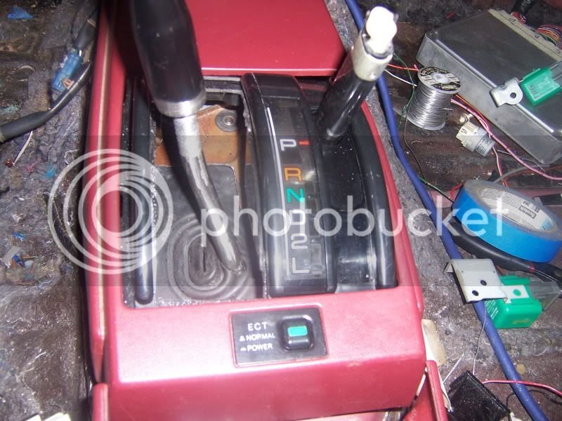

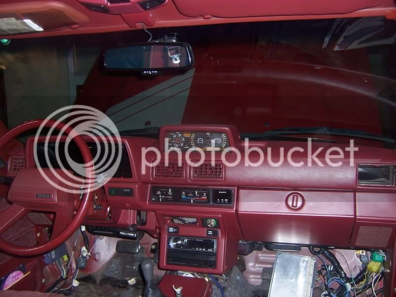

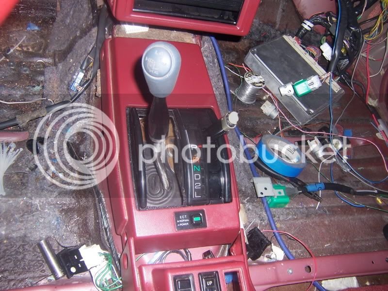

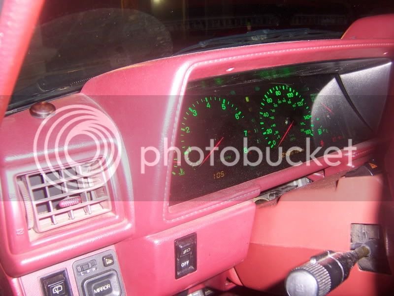

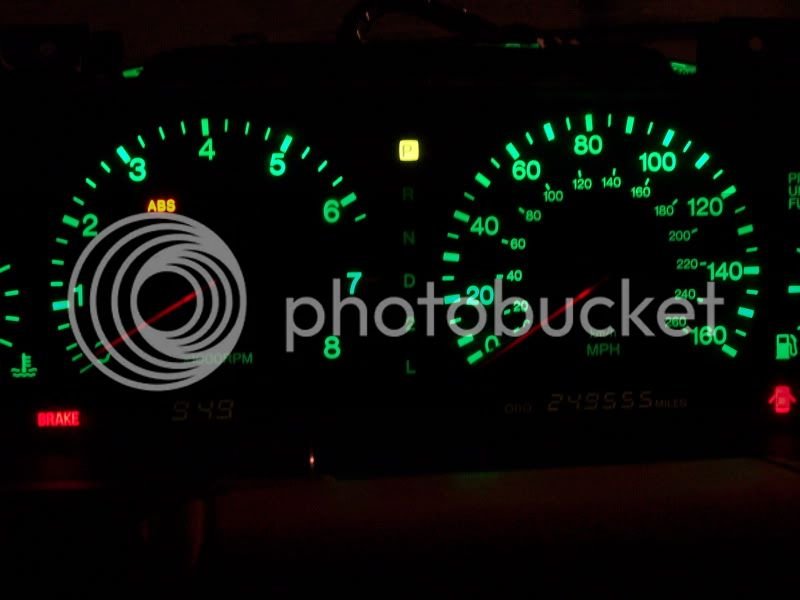

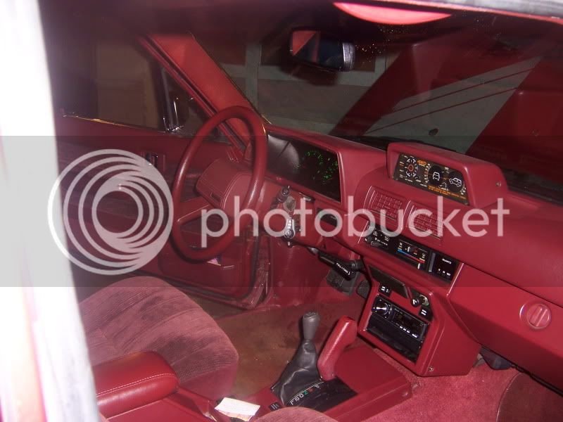

sc 400 cluster .. trying to figure how to mount it.
its alot smaller than the ls 400 one and fits in the original 4 runner cluster surround.

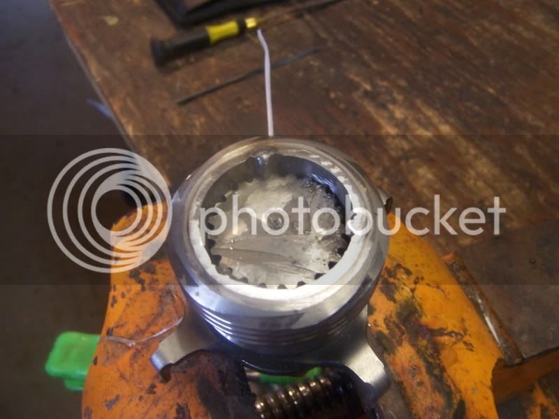

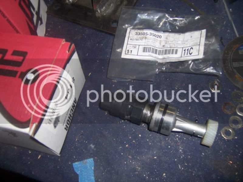

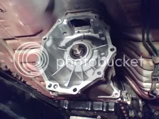

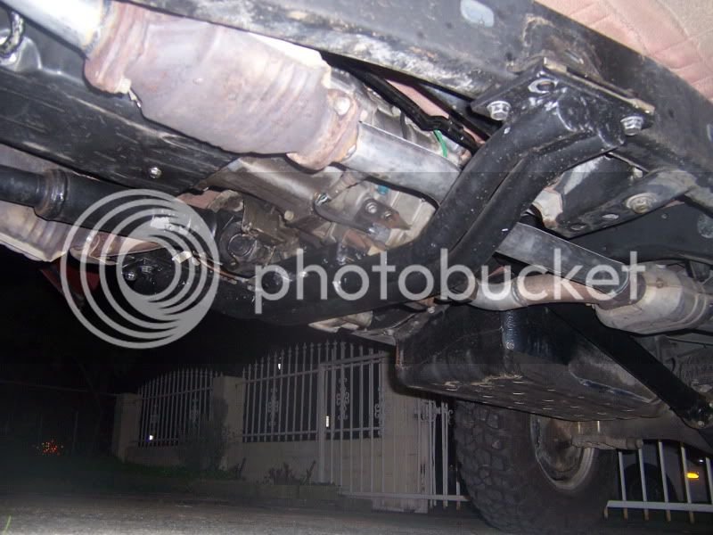

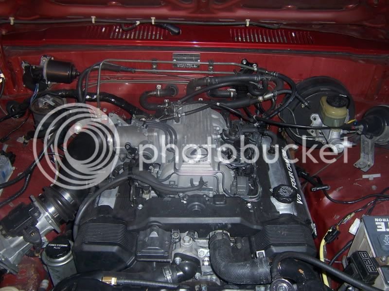

ok so i dont know how to edit my first post .

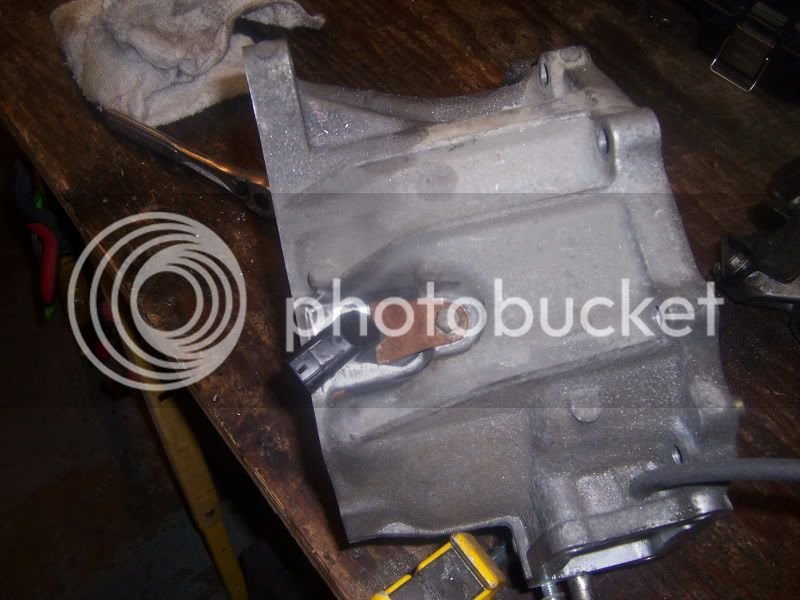

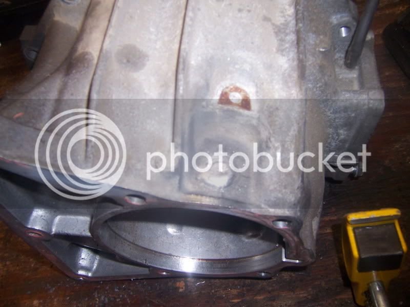

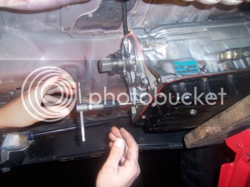

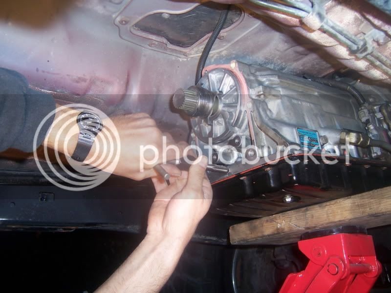

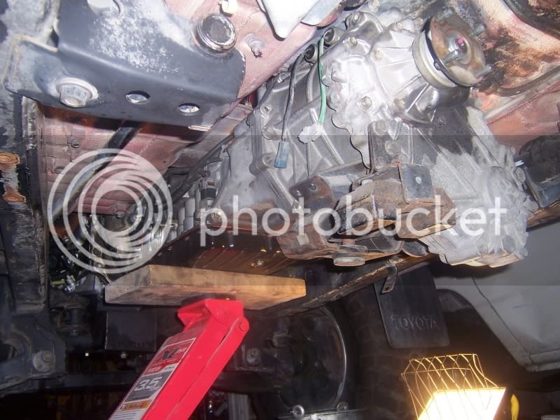

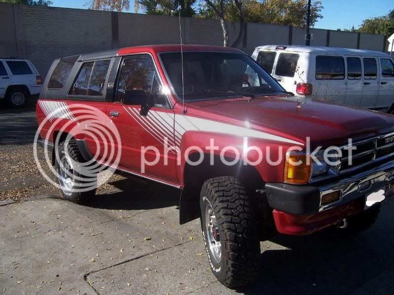

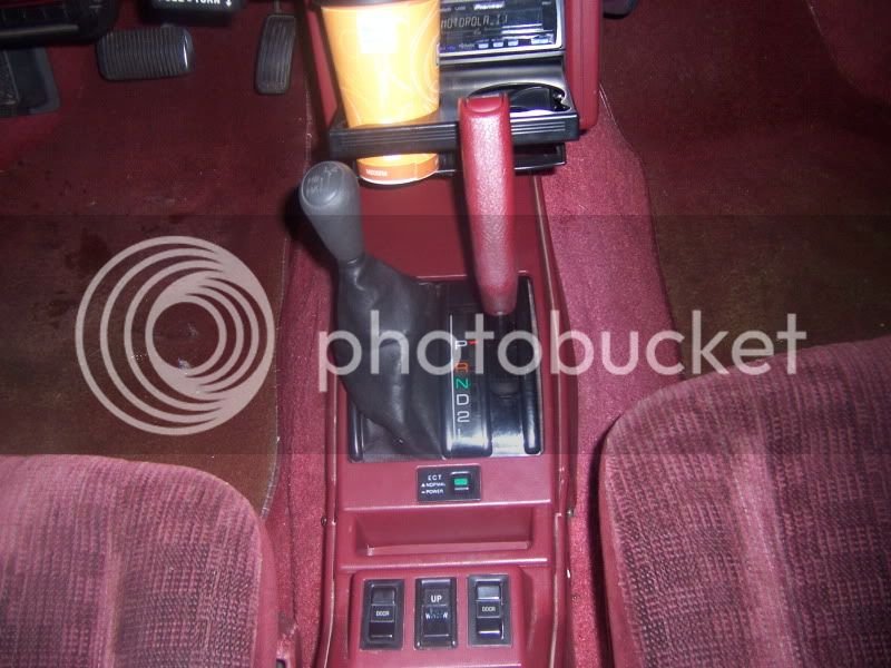

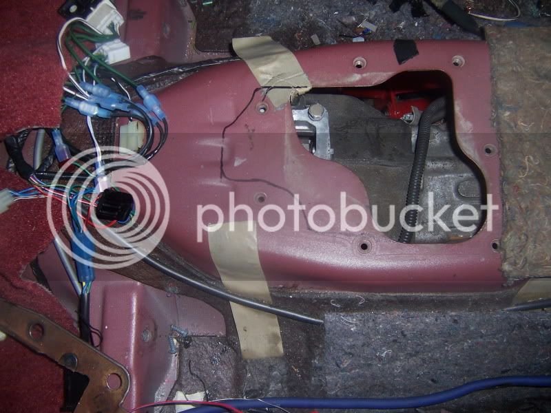

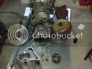

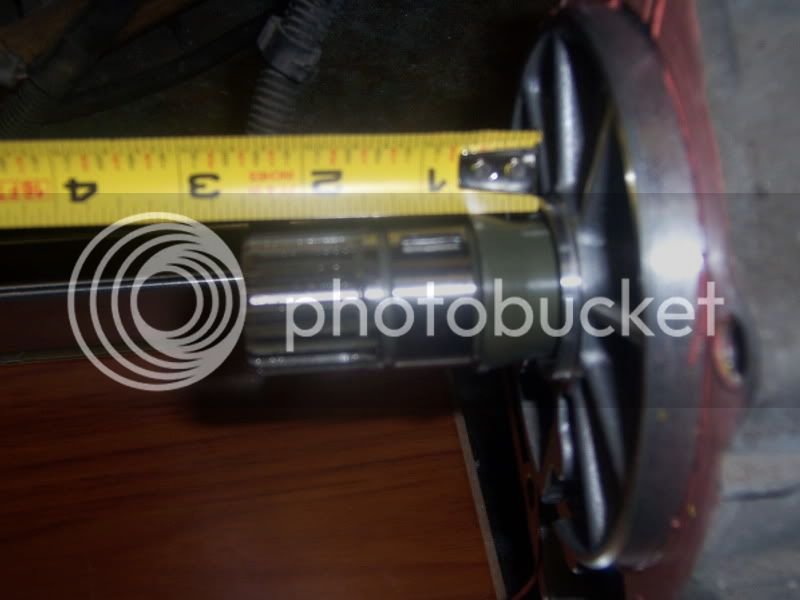

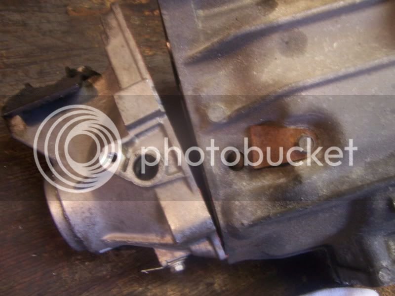

we did not use the inchworm adapter , they were taking to long in making them . found a guy using the 1995-1997 t-100 4x4 auto extension housing and transfer case mated to the lexus auto... so we ended up going that route , worked great .
we did end up installing a body lift on this truck 1" also..,
trucks been done a few weeks and works great ..
