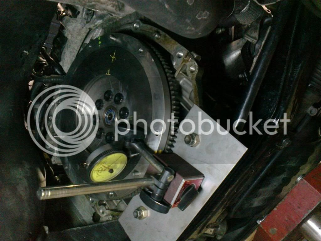

-checked flyweel for axial uncorrections (see pic)

![Foto0404.jpg Foto0404.jpg](https://www.lextreme.com/forums/data/attachments/22/22267-7a4af273f6272c4e990448bdfe212039.jpg?hash=ekryc_YnLE)

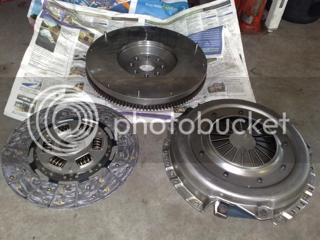

2 years ago i did a 1uz-fe manual swap in my bmw 323 86" with the following parts
Castle main rod shop:
-10" clutch + pressure plate
-bellhouse
-flywheel
![106a.jpg](http://www.rodshop.com.au/trans_conversions/bh/106a.jpg)
With the w58 supra mk3 transmission.
