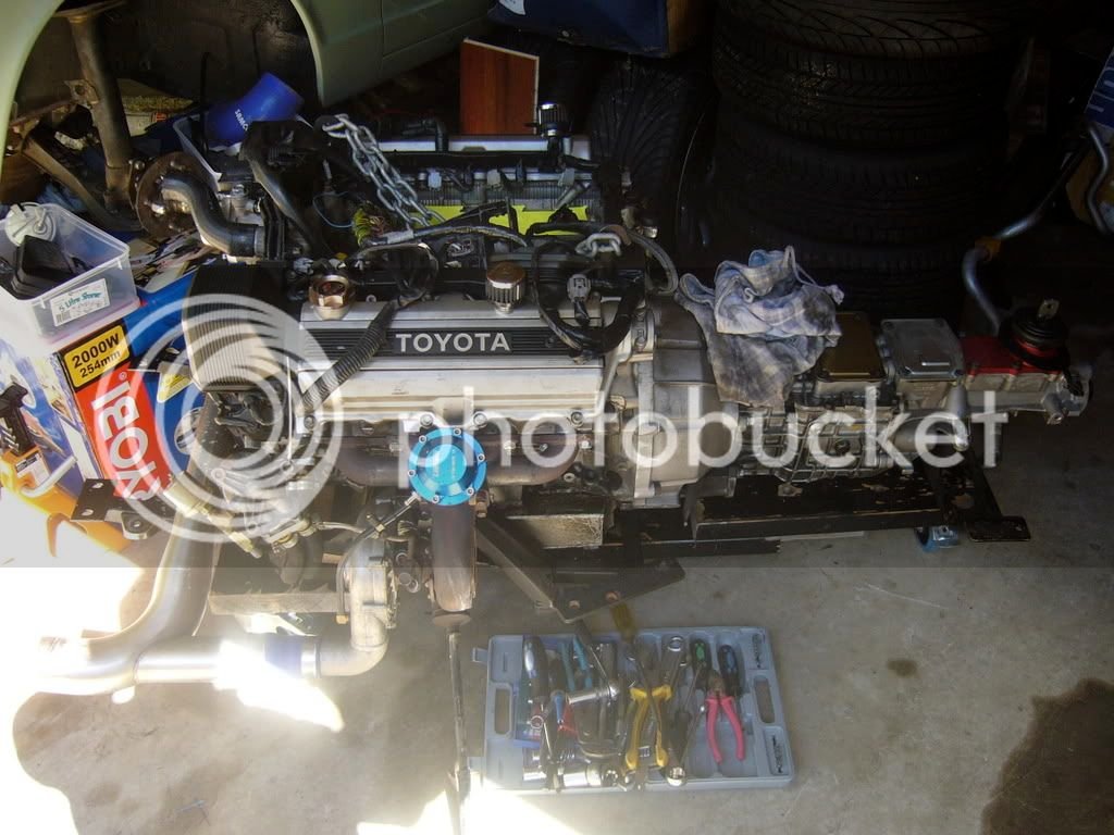

^ when you got 260rwkw on 6.5 psi, what exactly where you doing?
Check his sig link for a huge thread with details.
Basically twin turbos, log style turbo manifolds fab'd from 1.25" sched 10 steam pipe (1.42" ID)(36mm ID).
This on a stock unopened early 1uzfe with turbos, intercooler and tuning.
"1991 GrpA ST185 GT4 Celica
1UZ (stock internals)
twin KKK K26/27 turbos"
BTW, the manual transmission is good for some rwkW maybe 15 or so?
Better yet it has also been on the dyno for a tune tweek. There was no point going crazy as i'm still running the tiny final 2.5 inch muffler and both my external wastegate gaskets are leaking. Even so, on a tiny 6.5 psi it laid down a comfortable 265kw at the rear treads. Torque was also insane around the 680Nm....no wonder the poor W58 was having trouble hanging together.
Needless to say the box is getting upgraded to an R154 (all the budget can cope with i'm afraid). Maybe a T56 down the track but they are a bloody huge box which i don't think will fit?
