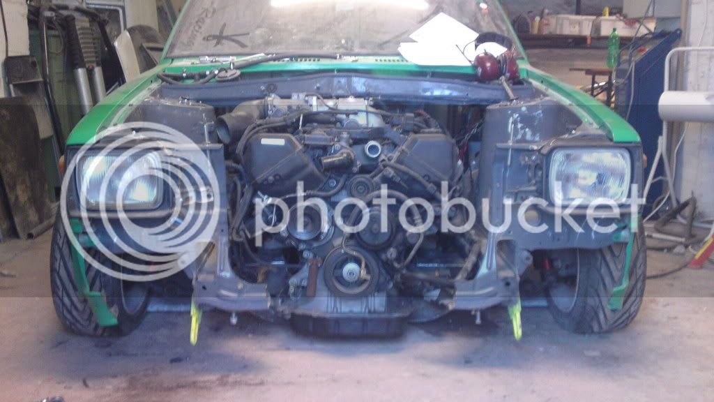

Hello.
I have a problem with my new engine. It came without a ECU, and I have problem finding the right one.

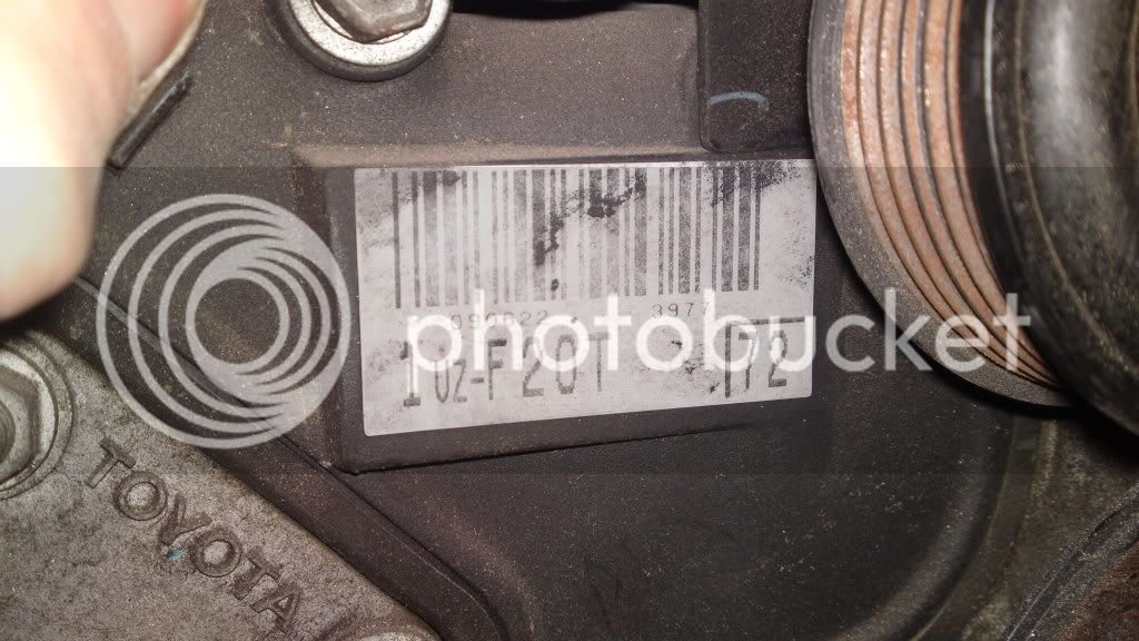

The engine says 1Uz-F20T.
Does someone know??

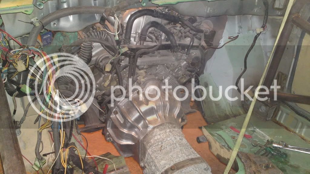

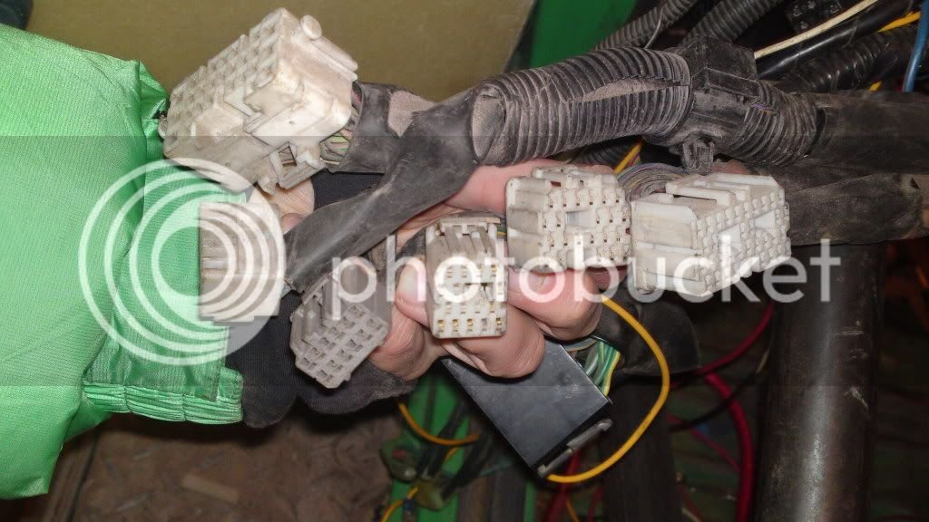

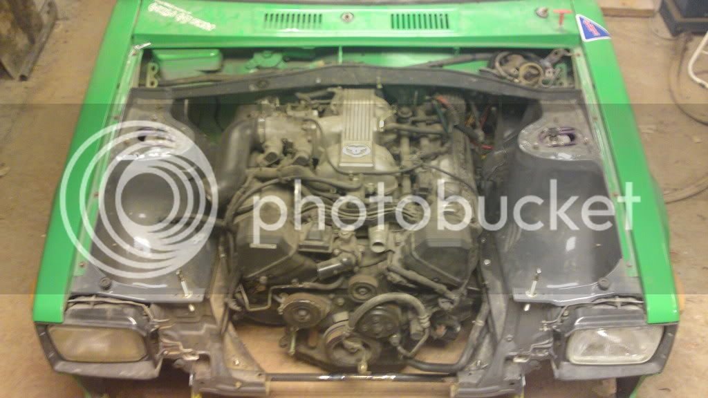

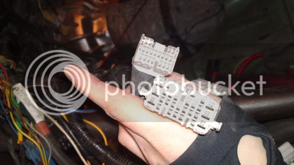

Can you show us the plugs for the ECU and body? and a few more of the motor? EGR or not? Wheres the FPR? Throttle body? Air flow meter? Cheers
Looks like a UCF20/21 motor so will need the 28/16/22/34 pin ecu with the header plug offset to one end of the ECU. NO EGR. I have several but dont have the 28pin plugs at the moment. See if you can find one locally first. Cheers
