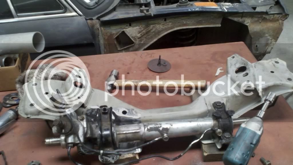

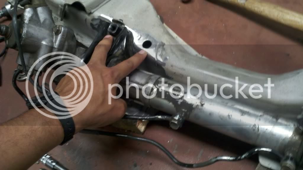

There is no issue with the steering knuckles, it's a steering rack issue and you have to shift your rack over 3-4 inches, and use a rack spacer that I make, otherwise you will have to custom modify your exaust manifolds or you have to make custom headers. I've done both in cressida's.

is there still the steering rack issue/headers, in the x8? or does that all clear.
yup still an issue, that's why you have to modify the manifold to clear the strreing shaft, or you have to get a rack spacer from me, and then shift the rack over the same distance as the spacer is long.
